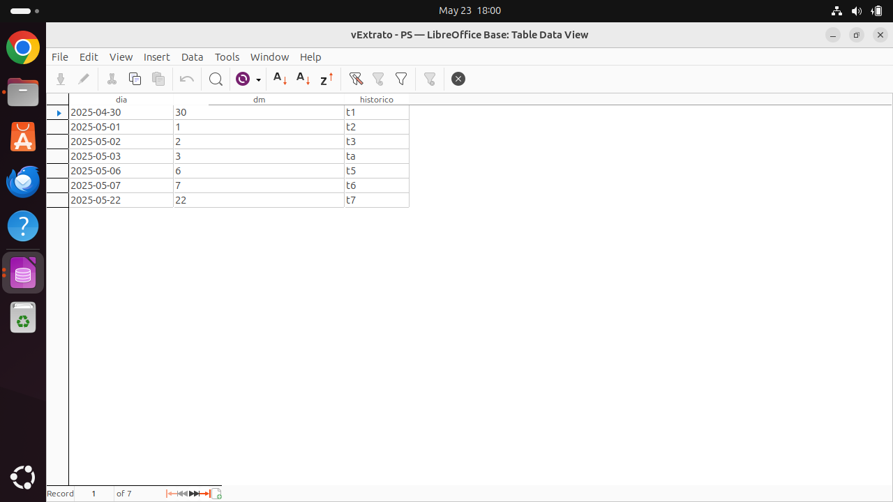

In a SQLite database I have a view with a column strftime(“%d/%m”, dia) AS dm
This formats a date (yyyy-mm-dd) column “dia” as dd/mm.
In the database, view displays ok. But on Base, column displays only d, without padding 0 and following “/mm”!
Any ideas?

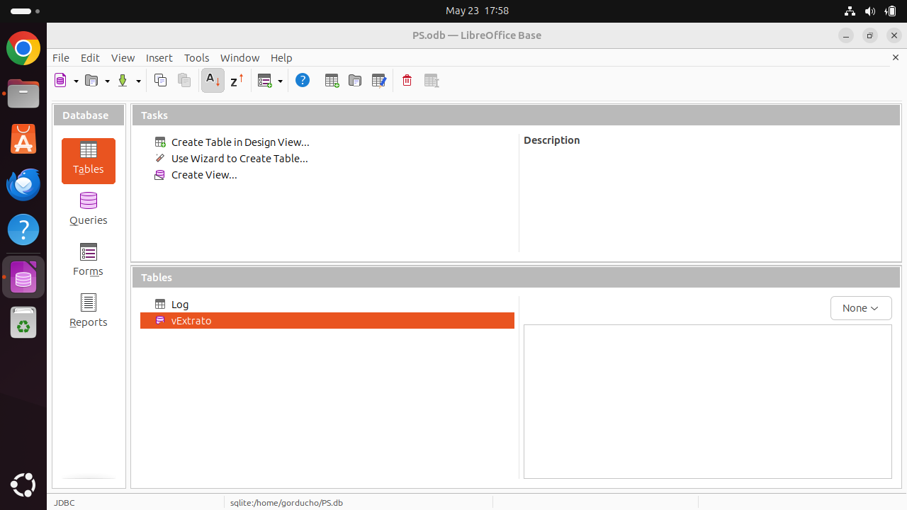

But please take notice that real problem is direct visualisation of view “vExtrato” that correctly shows itself in Tables section of Base.

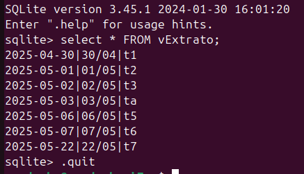

CORRECTION (sorry!)
Yes! In > Tools > SQL
SELECT * FROM vExtrato
Execute > Output of SELECT displays ok dd/mm!
So, problem is: why not in the GUI grid?

The report:
Bildschirmfoto von 2025-05-23 22-46-40
Yes… will try to add images.

View_Terminal

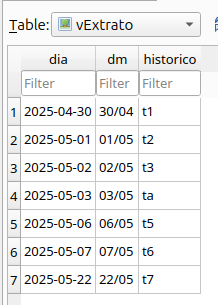

This is from DB Browser for SQLite:
vExtrato_DBBrowser

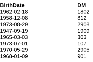

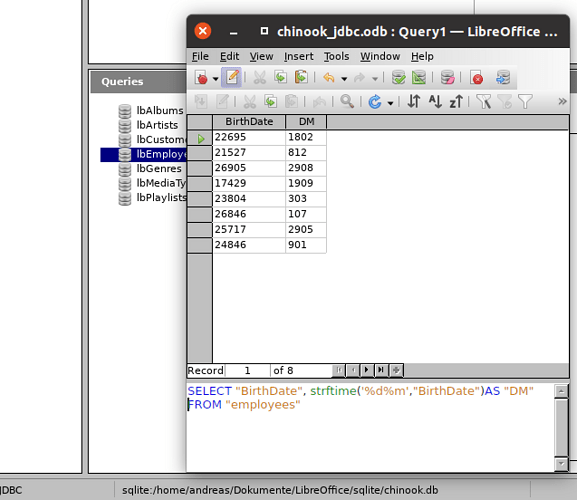

With an ODBC driver, Base shows all 4 digits.
