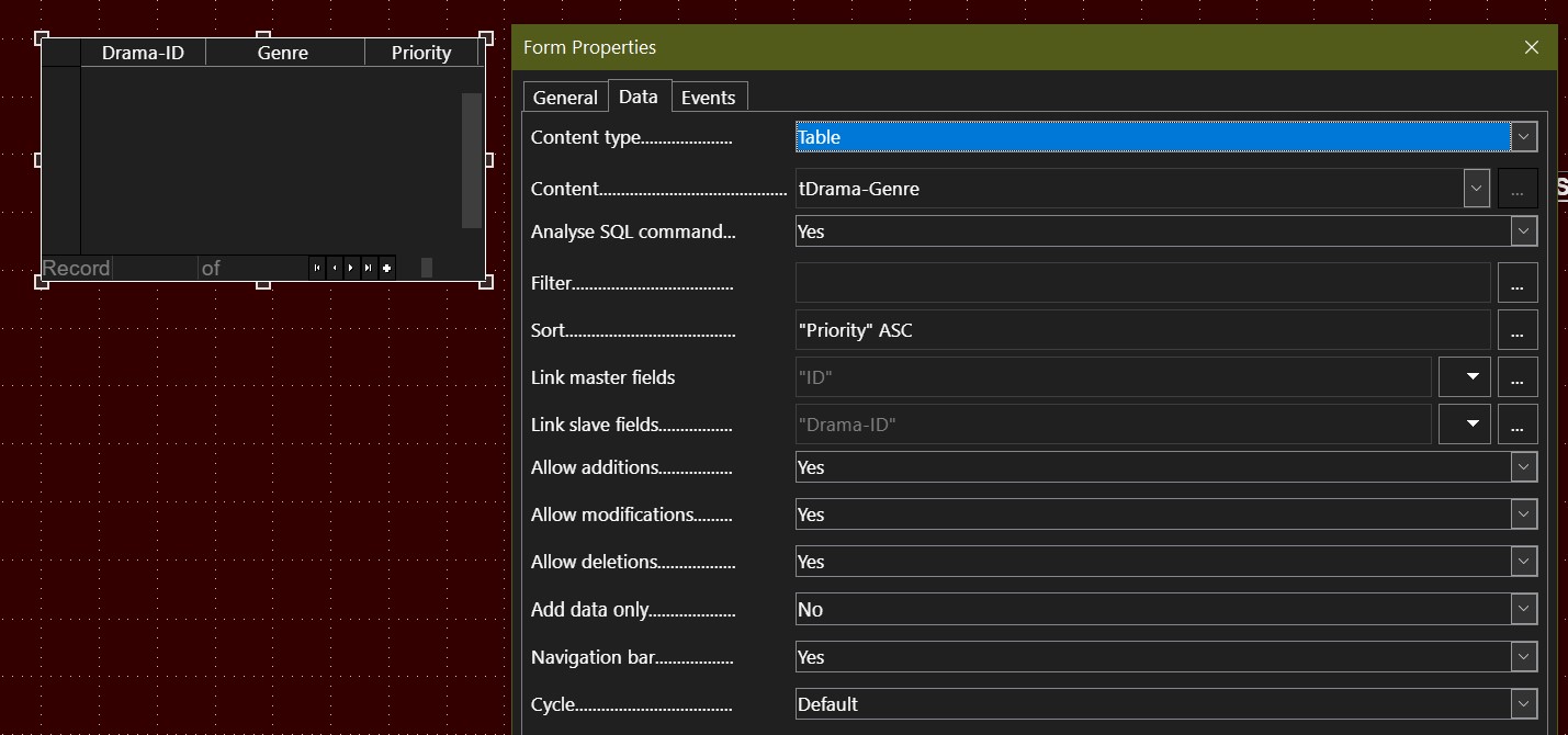

This is why I said I need to do more reading to understand the process better. I have a subform on my current data entry form that I thought I’d setup to allow me to add new genres (see screenshot). but when I try, it doesn’t work - I can select genres already in the table from a dropdown, can’t add new ones. Since I’ll need to add new persons and roles often in my new database, clearly I need to do more reading and study to understand how to get this right

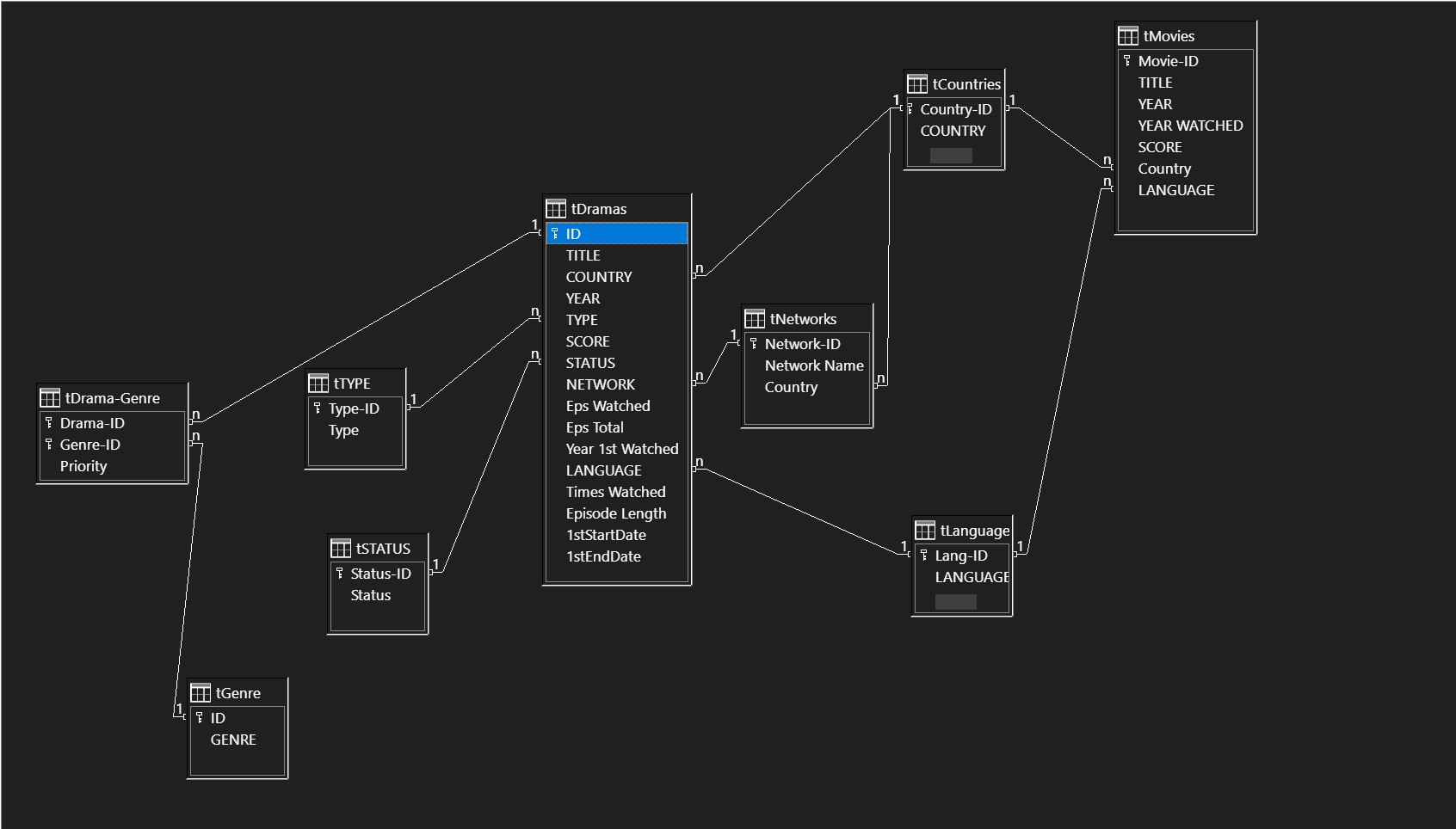

Thanks. Your comment highlights why I’m looking for easy to use ERD software. I have poor motor skills so pen and paper not really an option. Here’s a screenshot of my current DB relationship table. It works quite well, but I want to move away from embedded and add the personnel information.
So, for that table “Dramas” you could link a table like, say
“Drama_Persons” to relate
  1. the persons you want to associate to it (the Drama) – (fk) from the table “Persons”;
  2. the roles each one had in it – (fk) from table “Roles” (best) or from a ComboBox list.
