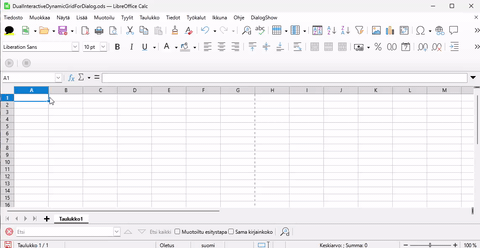

DualBindingDynamicGridForDialog
Using your imagination and code ideas, you can build a system that communicates bidirectionally between client and server that beats the DDE link system at any time.
DualBindingDynamicGridForDialog.ods (20.7 KB)
