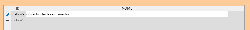

My question is: suppose user inserts
“louis-claude de saint-martin”
code adjusts it to
“Louis-Claude De Saint-Martin”
But user wants it as
“Louis-Claude de Saint-Martin”
So user must be able to edit it before INSERT (saving to DB) record.

Capitalizing works fine. But after seeing the result, user may not want it as it is. So she/he must be able to edit it — without repeating the routine of course.
