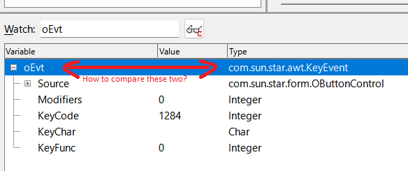

If I point a button events “key released” and “mouse button released” to the same sub/function, is there a way to determine which event was activated?
I thought of raising an error, but would like to find a more graceful method of doing this:
I came up with the following solution/workaround, but if someone would be kind enough to suggest a more germane approach, I’d be very grateful.
dim x as string
x = oEvt.dbg_properties
x = mid(x, inStr(x, “”"")+1)
x = mid(x, 1, instr(x, “:”) -2)
This gives the full event name. In my case “com.sun.star.awt.KeyEvent” or “com.sun.star.awt.MouseEvent”
… then I create additional difficulties for myself.
