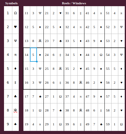

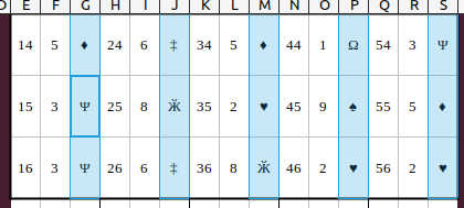

Hi @Villeroy No! not filtered. It’s a stepped process.
The “Screenplay” sheet displays the VLookup result for other formulae on the “Coding” sheet.
Example: Special Character Images
Top left formula is: =$Coding.$G5
Below it formula is: =$Coding.$G6
Below it formula is: =$Coding.$G7
The formulae that these “Screenplay” image refer to are:
The “Special Characters” are based on another lookup via the single digit numbers that are randomised: =RANDBETWEEN(1,9)
Finally, the randomised numbers then lookup the corresponding “Special Character”.
Please disregard the double-digits as they were for references only and will be deleted soon.

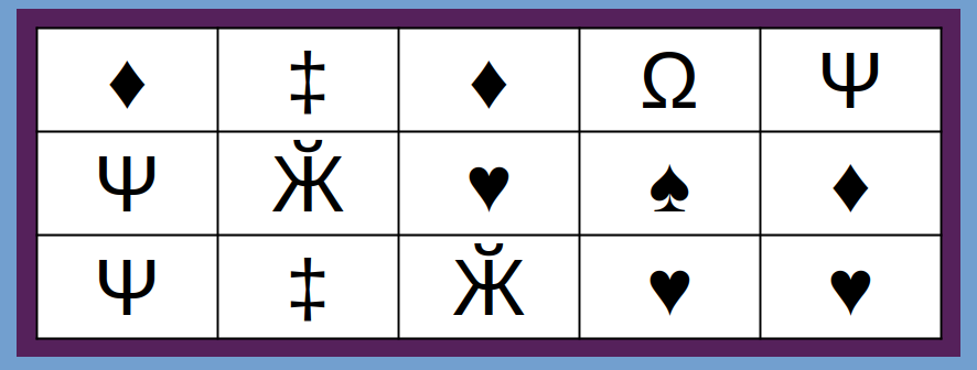

I am pretty sure any of these IMAGES can be replaced by a real Unicode-character without any hazzle displaying IMAGES …
Quite close: Ω‡ҖΨ♠♣♥♦
