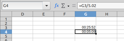

Hello,
Why not cells formatted as HH:MM:SS then G3 = time & other cell is =G3/5.02
Gives:
image description
The result cell could even be formatted with MM:SS.00 to result as 05:09:16
Oh, thanks Ratslinger. Just saw your answer after I posted mine.
Will have a play with formatting your solution.
Ah, got it: format answer as M:SS (assumes I’m never slower than 10 mins/km).

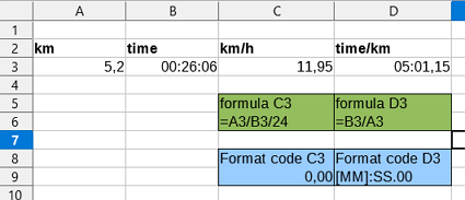

Why so complicated
image description
Runtime.ods
