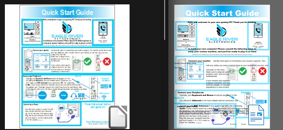

As of last week, any document I want to open with any kind of formatting beyond standard paragraphs has been majorly bunked up. It’s like… everything gets bigger, irrespective of everything else. Font gets larger, so that text that fit neatly on one line is now too large and has to cut itself off onto two different lines. Text centered between images A and B now overlaps with both images. Borders get bigger and start overlapping with neighboring borders. Spacing between things gets bigger so that a space with two “paragraphs” of text suddenly has the lower text much further down the page. Etc. EVERYTHING gets bigger. (Except for embedded images…) It’s completely screwed up a large number of documents I use and made them unusable.
I’ve attached an image above. The left side is the “correct” side. This is the thumbnail as seen in the “open a document” window. The right side is the current side. It’s what it looks like currently in Libre Office.

Click on the larger text, if you look in the font field, is the font name shown in italics? If it is, it means that the font used cannot be found by LibreOffice and a substitute font, which may have different metrics, has been used to display the document.
Installing the missing font(s) should resolve the issue

I would hazard a guess that the font for the main heading, Quick Start Guide, is supposed to be Arial Narrow

Here you see the definite difference in fonts:
@EarnestAl’s guess is probably the cause of the problem: a missing font in your OS.

Thank you for that suggestion. All of the fonts used in the original document (and all my documents) are default Fonts that I did not install independently, just those that came pre-installed on either my desktop or LO. Something like “Arial Narrow” would probably be right.
Perhaps a Windows update removed my fonts? Or messed them up some other way? This would explain why LO update didn’t match the time period, and I was looking in the wrong direction.
I have checked and the font name is indeed in Italics. But it is listed as “ATX_N”. I do not know what this is, and a quick google search for “ATX_N font” or “ATX font” yields no good results. Any ideas?

I do think @EarnestAl is correct after checking my fonts and finding they are ALL labelled as “ATX_N” and italicised. And they did say that italics means a font not installed.

Okay, after taking some time to respond to everyone, I went and downloaded “Arial Narrow” font pack. Installed it, opened the file and selected all, chose “Arial Narrow” as the font, and… success?
It fixed about 95% of the problems. Still slightly formatted wrong and some things need a bit of wiggling to put to rights, but a manageable task instead of basically having to remake the whole document. On my simpler documents it fixed them at least close enough to the original that it doesn’t matter, and I only have a few as complex as this example. I’ve only tested a few documents out of the many affected, but confident this solution will work equally well on all of them!
I’m marking your answer as the “solution” and thank you SO VERY MUCH for not only being smart enough to know the issue, but even identifying the correct font (or one close enough) that it can salvage my work!
