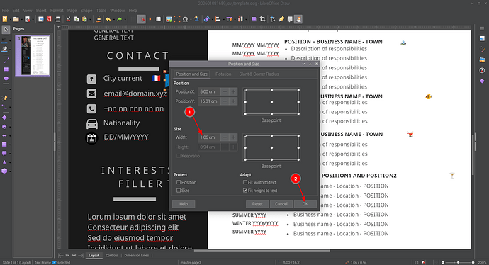

I’m creating a CV template on LibreOffice Draw and I have a small UN flag emoji that I need to resize to the same size as the French flag emoji.
The image/frame’s Size option lets me change the width size, but height and keep ratio are both greyed out and inactive.
CLI
xml code: https://termbin.com/r60b
GUI

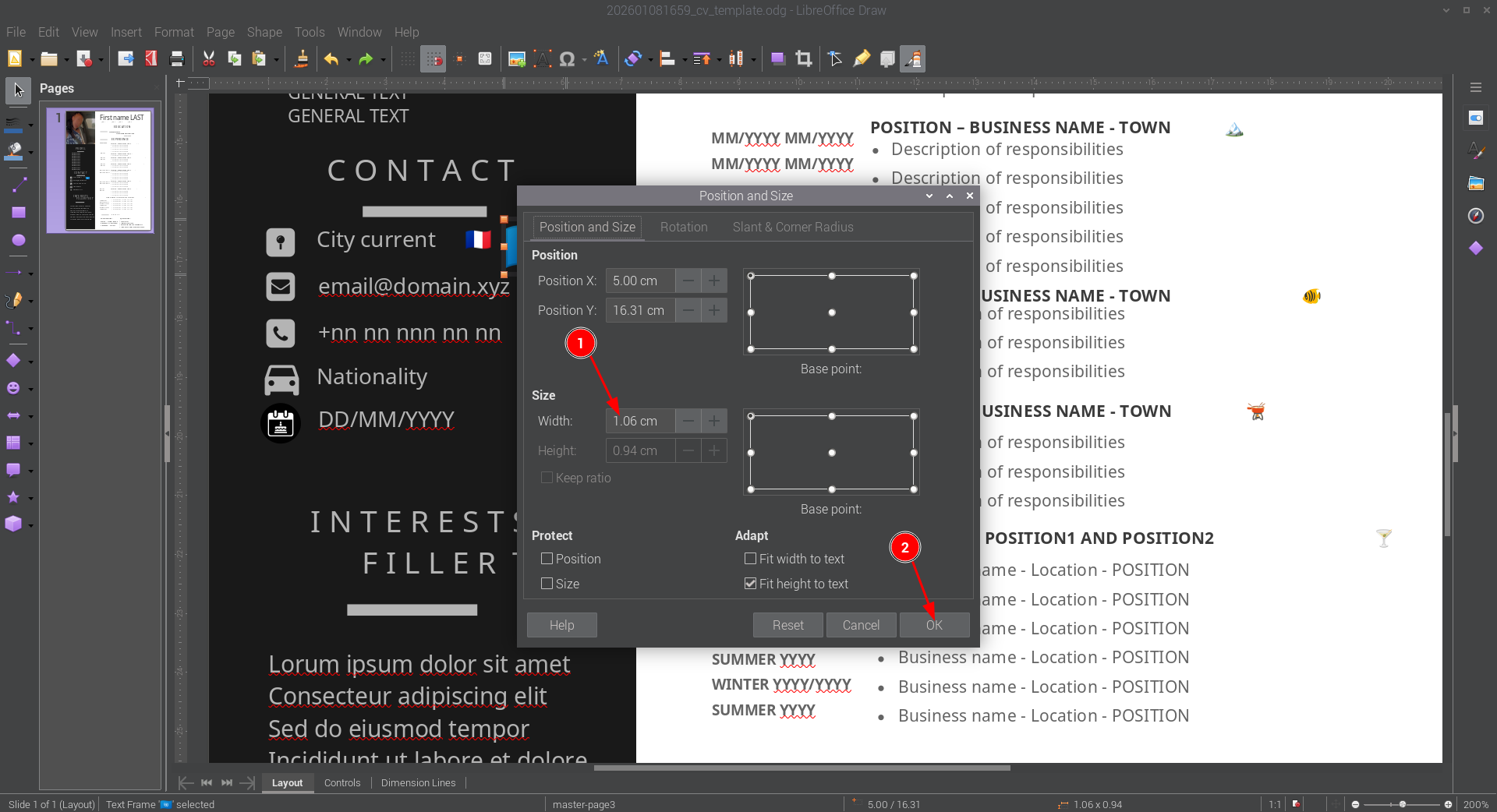

LibreOffice Draw 7.4.7.2 → right tap image/frame → tap Position and Size… → Size → Width: 1.06cm → change to 0.46cm → tap OK → image frame shows as a tall thin object.
I tried resizing with xml, but having trouble with Vi search finding the image.

This is because you have a Text box, not an image. Usually on such a shape, you tick Fit to text to cause the “frame” to auto-adapt to width. You must manually adjust height.

I discovered the solution to resizing is to untick Fit height to text.
Breadcrumb/path: LibreOffice Draw 7.4.7.2 → right tap image/frame → tap Position and Size… → Adapt → untick Fit width/height to text → Size → Width/Height → tap n.nncm → change to n.nncm → tap OK.

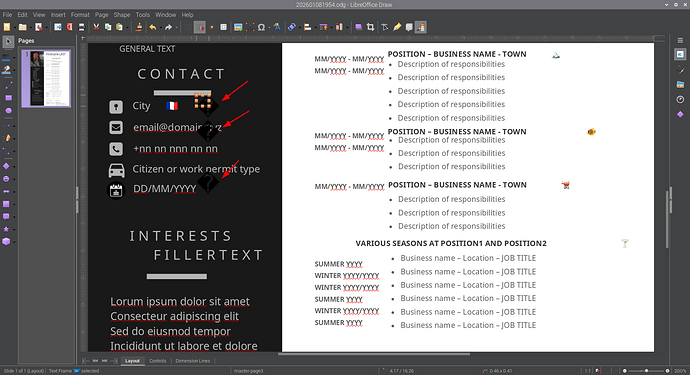

Unfortunately, perhaps due to the image/frame not being an image but rather an emoji character, the resize to Width: 0.46cm and Height: 0.41cm causes the emoji not to resize but to display question marks.

Emojis are characters. They are handled as text. So, think “typography”. All your other “decorations” (ski, fish, barbecue, sail boat) are text emojis. Your document contains a single image, the blurred photo at top left.
Since emojis are text, they can only appear where text is allowed. Therefore, you must use a shape, the simplest of which is a text box. The difficulty may come from this support requirement: text must be hosted by a Draw object.
