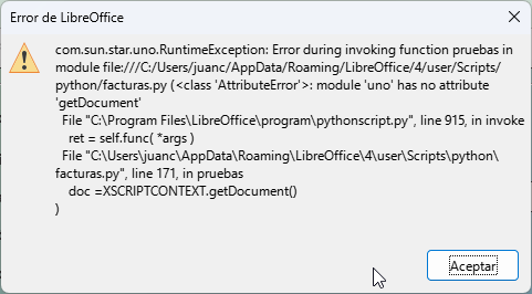

Both XSCRIPTCONTEXT in python and the XScriptContext interface have the getDocument method, but if I try to use the method, for example, by running doc = XSCRIPTCONTEXT.getDocument() after the import from access2base, I get the following error:
What am I doing wrong?

I can reproduce the error on my system. It looks like a library error to me, as it “delete” the reference to XSCRIPTCONTEXT. I’ll check the code and let you know.

If I read the error right, it happens at line 171 of your code. Is this the first reference to XSCRIPTCONTEXT ?
Yes, it is the unique reference, just used to test. It is from a macro into a .odb file.
I don’t think is an error in my code, but a kind o error in access2base, but I’m trying to see if somebody has the same problem and if somebody has solved it or found a workaround.

Use simply:
# coding: utf-8
from __future__ import unicode_literals
import uno
from access2base import *
def puebas(event=None):
    Application.OpenConnection()
    doc = THISDATABASEDOCUMENT
    return
