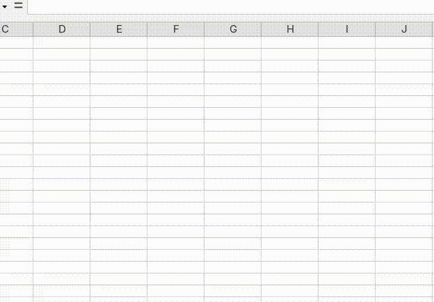

I have never used ScriptForge, but if you have a standard UNO object in this variable (button_help), then you just need to add the respective listener.
For example:
button_help.addMouseListener(EventsMouse())
You can see EventoMouse and other classes controllers at:
Only like example:
import easymacro as app
class Events():
    def __init__(self, dialog):
        self.d = dialog
    def cmd_help_click(self, event):
        app.msgbox('Click')
        return
def main():
    opt = {
        'Title': 'AIHordeOptionsDialog',
        'Width': 100,
        'Height': 50,
    dialog = app.dialog.create(opt)
    opt = {
        'Type': 'Button',
        'Name': 'cmd_help',
        'Label': '?',
        'Width': 50,
        'Height': 15,
        'X': 10,
        'Y': 10,
    dialog.add_control(opt)
    dialog.events = Events
    dialog.open()
    return
dialog
You don’t have to use easymacro, just follow my source code to reproduce the event.
