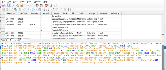

I can create a simple query of the main table, i.e. simply output all the data in this table, and you get the expected output for the two date fields.
Now JOIN this table with another to add in names associated with the records, and add code to remove duplicate information in the output for the second (and third, and…) person.
Note that the two date columns are displayed as a number, not a date.
I realize that I can simply right click on the column(s) and change the format to the required DATE format, but you need to remember to do this every time.
What is different between the two examples that would change the output?

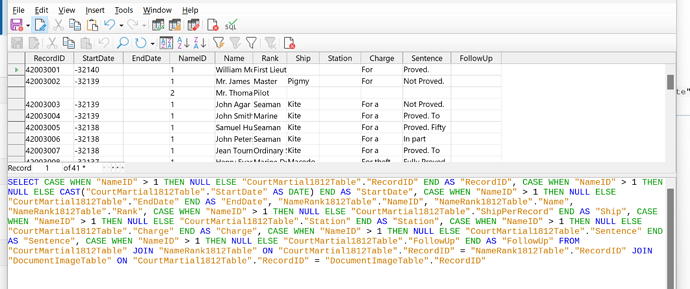

The display output can be shown as a date if you CAST the field such as:
CASE WHEN "NameID" > 1 THEN NULL ELSE CAST("StartDate" AS DATE) END AS "StartDate"

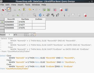

“Ratslinger” asked why I didn’t show two examples as my post suggested.
Answer: I’m a new user and the system would not allow me to have two media attachments.
I had to delete one - the least useful one.

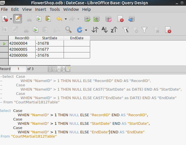

Second: Your solution to CAST the date back to a DATE (which it already is) did not work for me when I tried it, and it still does not work as you can see in the SQL code and query output below.
Thanks for the suggestion however,
No, that was not I.
CAST works for me. What database are you using? Can you post a sample redacted Base file?

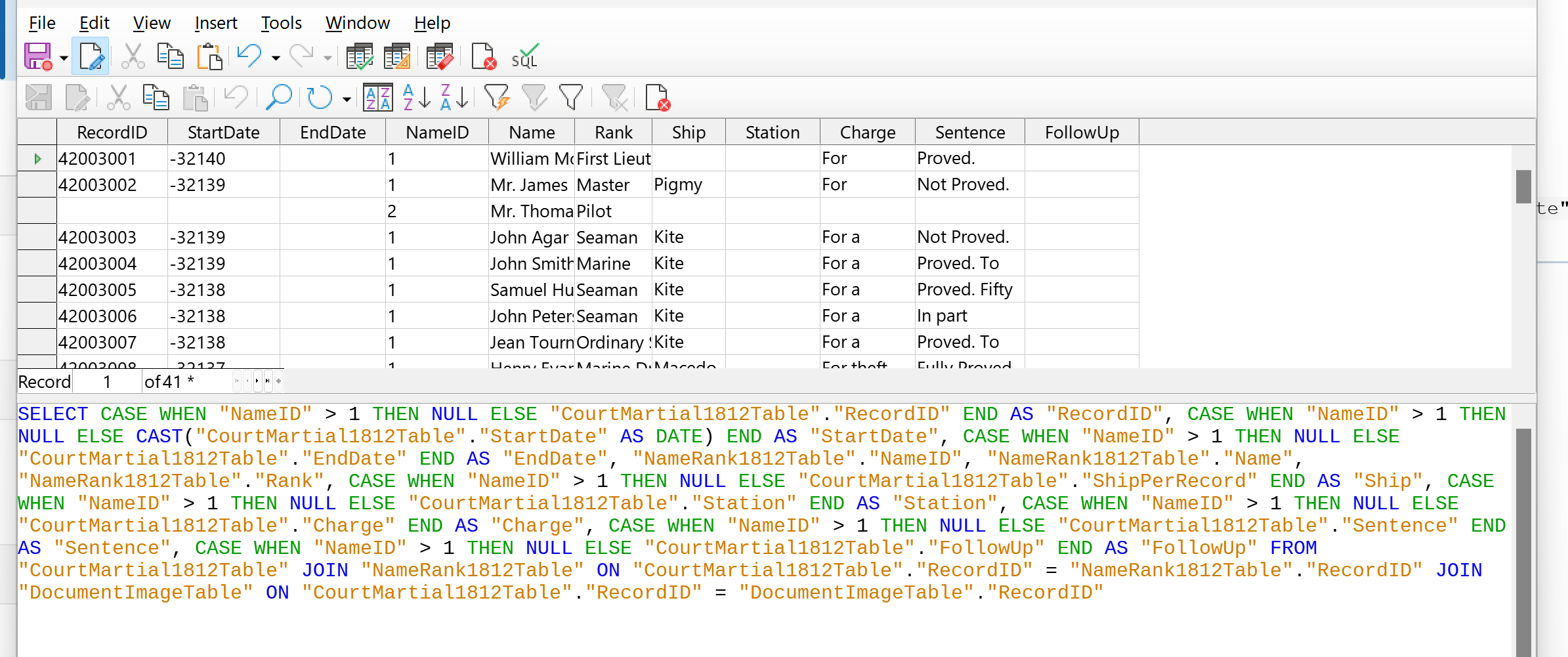

Yes that is my fault. I forgot that I turned on Run SQL command directly. You do not need the CAST for this to work.

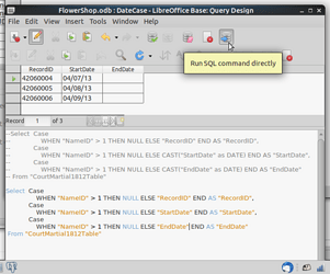

Without run directly:
With run directly on:
The naked Base grid shows calculated dates as integer day numbers. The number format of a date is completely unrelevant as long as the values are right. In a form or report you can format the values anyway you want. The underlying query is never shown to the database user.

When I did use the “Run SQL …” button the date fields (without CAST) did show up as dates.
The date columns were in MM/DD/YY format, but they WERE dates.

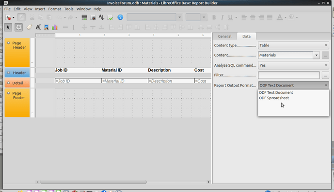

It is usually better to create a View for use in a report. Typically faster. Also, the report output can be to a Calc spreadsheet directly:
