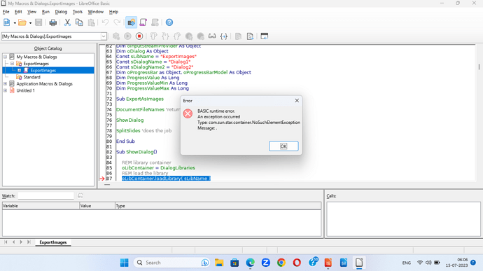

Export as Images - Extension when used in Impress 7.5.4.2 ends up with an error Basic Run time error

it is little bit strange thing for me that the Library “ExportImages” contains a subroutine what will load the Library “ExportImages” into the memory… How it can work before the Library is loaded in? What sub will load it really into the memory?
Note that it tries to load dialog library. And it is absent there, next to the Basic library.
This is how it is intended to look (see two dialog libraries):
So an extension installation problem.
