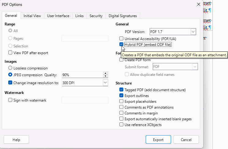

You can create a hybrid pdf which embeds the Writer document in the pdf. You can open it in a pdf reader, or you can open it from Writer.
Read please:
To create a hybrid PDF

As time goes by there came the idea to have the source-document appended to the pdf, so both is available at the same place: The hybrid pdf already mentioned above.
But also choose a pdf-viewer to show the pdf. LibreOffice is no good choice for this. (Imho the pdf-reader should show the appended file with an option to open it. Not all will do this. You may even find situations, where embedded files raise security alerts…

Your advice is sage…the hybrid pdf worked perfectly…thanks so much to this group…
