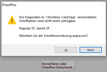

I have an old version of Serif DrawPlus X3 and it imports your file well. The program reads a conversion of some older version of SerifDrawPlus and replacing some fonts (which are not installed on my Windows10 machine). It shows page 2 of 3 pages (page 3 is blank; page 1 contains the image shown in @ms777 's comment).
For further assistance you may write a PN to me…
EDIT
You can export the file from Serif DrawPlus X3 to pdf or image format. See attached pdf file (pages 1-2).
