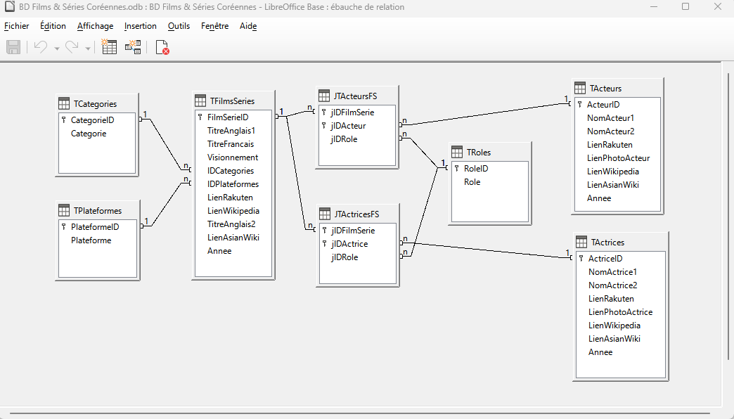

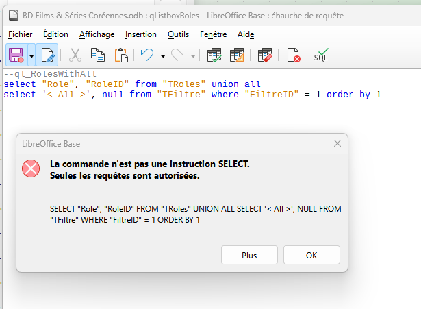

I seem to be having a bit of trouble with queries that throw errors that the command is not a SELECT statement. Could this error be related to the relational structure of my DB? Here is the diagram of the existing relations in my DB.
@Renel,
queries beginning ‘qf’ are data-source for internal forms and must be saved in parsed mode.
queries beginning ‘ql’ are used by list boxes, all are saved in direct mode.
I suspect the error is thrown by the SQL from the query ‘ql_RolesWithAll’, this is the only query which must be saved using direct mode.
I suggest using direct mode for all list box queries.
right click your list box queries, select ‘Edit in SQL View’, activate the SQL icon on the toolbar and save.
any problems, copy the SQL and post it.

I still encounter the same error and can’t figure out what could be causing the problem.
Error Instruction SELECT
