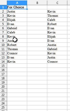

"Find All" occurrences of selected text or cell data via context menu?
I would like to be able to right click a cell containing data (or be able to select text manually) and click a context menu item that would then “Find All” occurrences of this text\data in the current document. I have checked the Tools:Customize:Context Menus screen but the various “Find” items don’t work this way and there is no way to send selected text (or cell data) to the “Find” field automatically.
Without this, if I want to highlight other occurrences of a bit of text I have to open find (Ctrl-F) and type each bit of data, or copy and paste the contents of a cell into the find field manually… and then use the mouse to click Find All (don’t believe there is a shortcut for Find All). If this process can be automated with one click in the context menu it will save several clicks, and a lot of cursor movement and typing.
If this functionality doesn’t already exist, is there a plugin that can do this?
I just played with recording a macro briefly by starting to record, pressing Ctrl-F, Ctrl-C, Ctrl-V, then clicking Find All. Surprisingly, the Find All part worked, but it doesn’t seem to record the actions of copying the selected data and then pasting it into the find box. It just searches for the exact data that was copied while recording. There is probably a way to make this work, but it may take me hours to decipher this since I have no experience with macros. It seems quite simple to set a macro as a context menu option at least.
Currently using LibreOffice 7.4 on Windows 10.
Thank you for any advice you can offer.

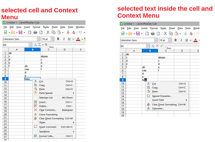

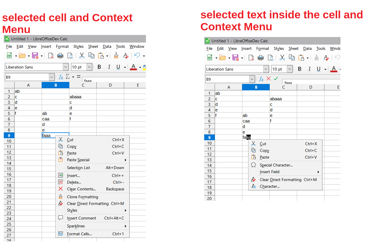

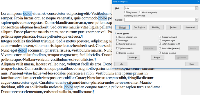

Something like this is a built-in feature in the Base component. You click any value in some column, then a toolbar button and the table is filtered by that value in the same column.
@KamilLanda @JohnSUN

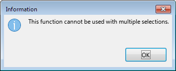

The code for whole words is easy, the same for case-sensitive finding → only next properties in object oDesc.
Sub FindAll
	dim oDoc as object,  oSheet as object,  oDesc as object,  s$,  oFound as object,  oSel as object
	oDoc=ThisComponent
	oSel=oDoc.CurrentSelection()
	if oSel.supportsService("com.sun.star.sheet.SheetCell") then
		oSheet=oDoc.CurrentController.getActiveSheet
		uno("Copy") 'copy selection to system clipboard
		uno("Cancel") 'cancel edit mode if needed
		s=getTextFromClipboard 'get text from system clipboard
		if s <> "" then ' We will not look for empty cells
			oDesc=oSheet.createSearchDescriptor 'search descriptor
			with oDesc
				.SearchString=s 'searched text
				.SearchWords=True 'only whole words
				.SearchCaseSensitive=True 'case sensitive
			end with
			oFound=oSheet.findAll(oDesc) 'Find All
			oDoc.CurrentController.Select(oFound) 'select found items
		end if
	else
		msgbox("This function cannot be used with multiple selection or no-cell selection :-)",  32)
	endif
End Sub

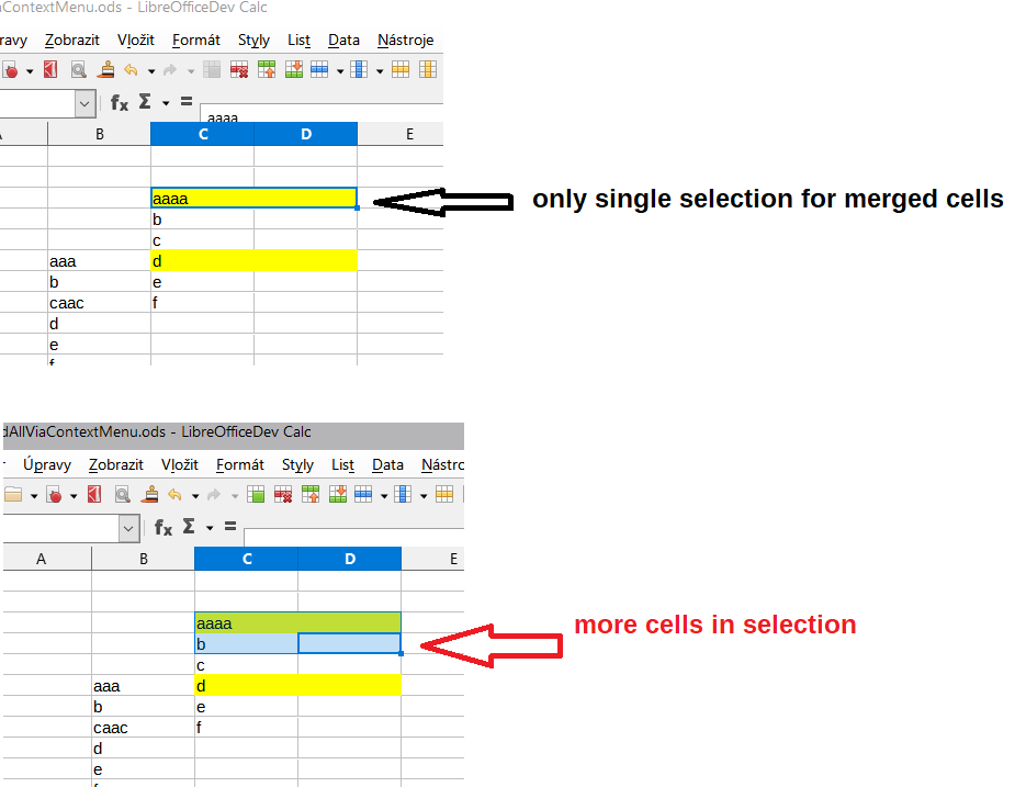

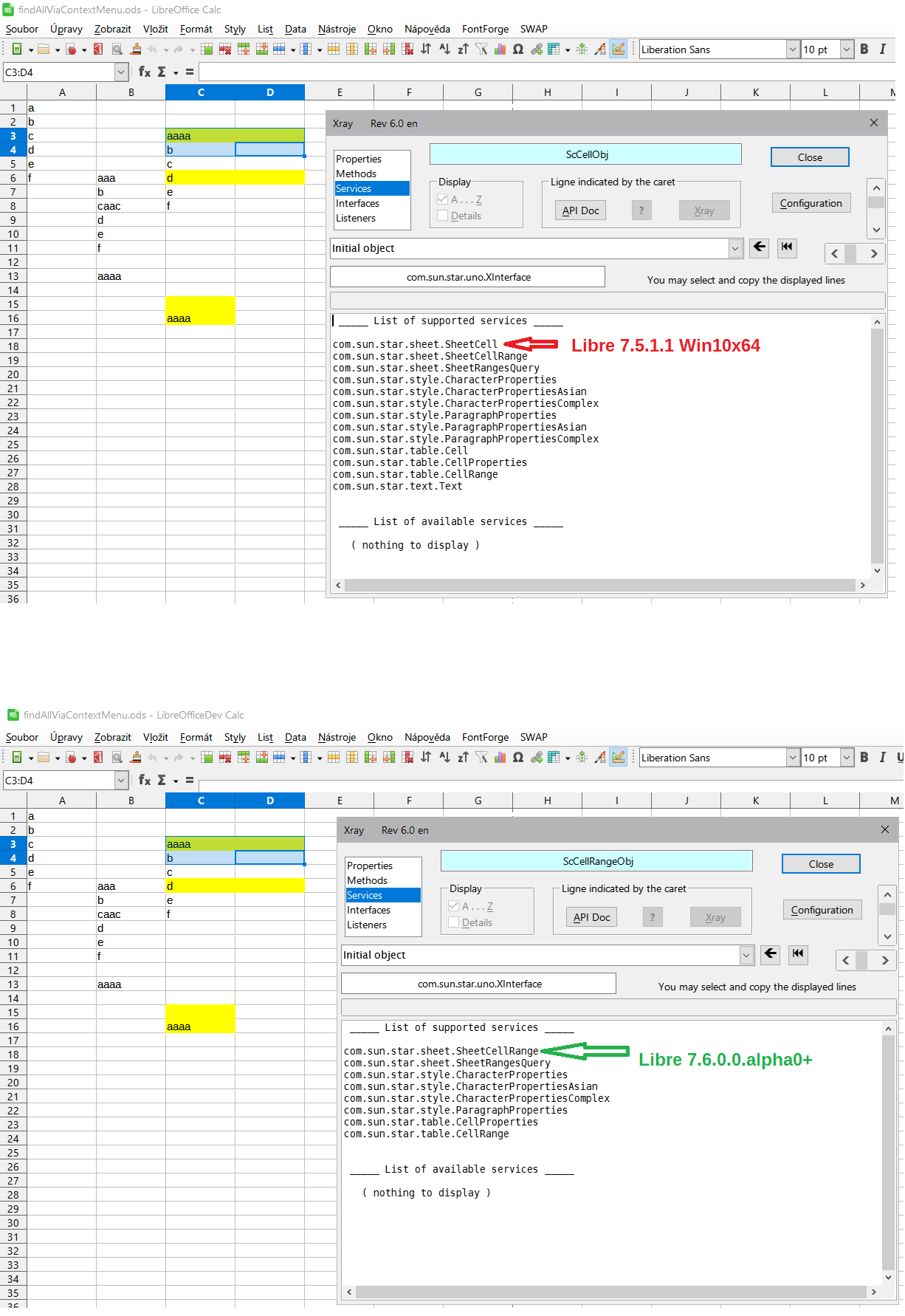

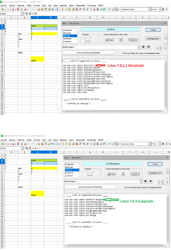

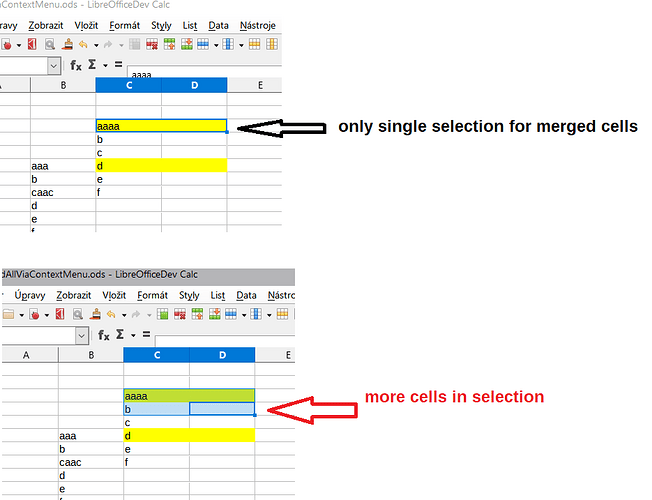

It seems there is bug in 7.5 and probably also in 7.4 because it supports com.sun.star.sheet.SheetCell also for the range. But it is fixed in version 7.6 (I tried some older 7.6. but you can test newest version Index of /daily/master/)
But I don’t know how to detect if only one merged cell is selected and take string from it, or if there is selection with merged cells and other cells.

Great, thanks for the info! I just tried installing 7.6 dev alpha and it installs but gave no shortcuts and did not replace my old version, so I get the feeling it’s meant for people who want to tinker with things and are okay with there being quirks. I could make shortcuts myself but if there are other quirks due to it being an Alpha version I’d rather not deal with those, as the 7.4 version works fine for me. I’m not really a power user when it comes to spreadsheets and office suites (more of a hardware guy) so I think for the time being I’ll just stick with the current stable version and just keep my macro using SheetCellRange until the stable version includes that fix.

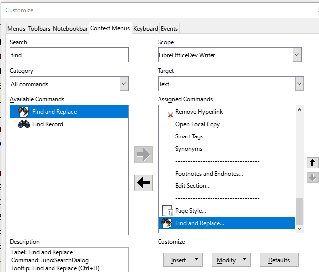

What I think a good approximation, only using the mouse.
Menu/Tools/Customize/Context Menus
To use:
Select the text to search.
Right-click, select ‘Find and Replace’
Click on 'Find ‘All’
@JohnSUN, the author wrote:
and I supposed the phrase: (or be able to select text manually) means: select the text inside a cell.
And because I didn’t recall how to get selected text from the inside of cell and I didn’t want to search it or discover via Xray/Mri, I wrote the “universal solution” via system clipboard, because I recalled quickly where this part of code is in my libraries :slight_smile: .
No, no, my friend, I’ve been misunderstood: I’m not criticizing a great solution - I’m trying to help improve it. The check that I suggested to insert into the code, just to help avoid the error message in the case when more than one cell is selected when running the macro.
@JohnSUN: I didn’t read your note like criticism, really no :slight_smile:. I read it like normal question for possible improvement. And I wanted only to write my reasons for that solution :slight_smile:.
Of course it isn’t problem to add the condition if only one cell is selected, and you are right it could be better. But still I’m not sure if there is needful the detection of selected text inside the cell. So I hope the author will write his feedback.
I added a little to your code: I refused to search for empty cells even if the macro was called for an empty cell or from edit mode but without selecting a part of the string. To do this, I had to enclose a type iteration loop in an error handler and add a search string check. In addition, I added an exit from the edit mode before starting the search.

I think there is missing only one thing in the code :slight_smile:
If oDoc.getCurrentSelection().supportsService("com.sun.star.sheet.SheetCell") Then
Else
	MsgBox("This function cannot be used with multiple selections or no-cell selection :-)", 32)
End If
If you add the macro to the sheet cell’s context menu, you can omit that test. The command will not appear in a range’s context menu,
