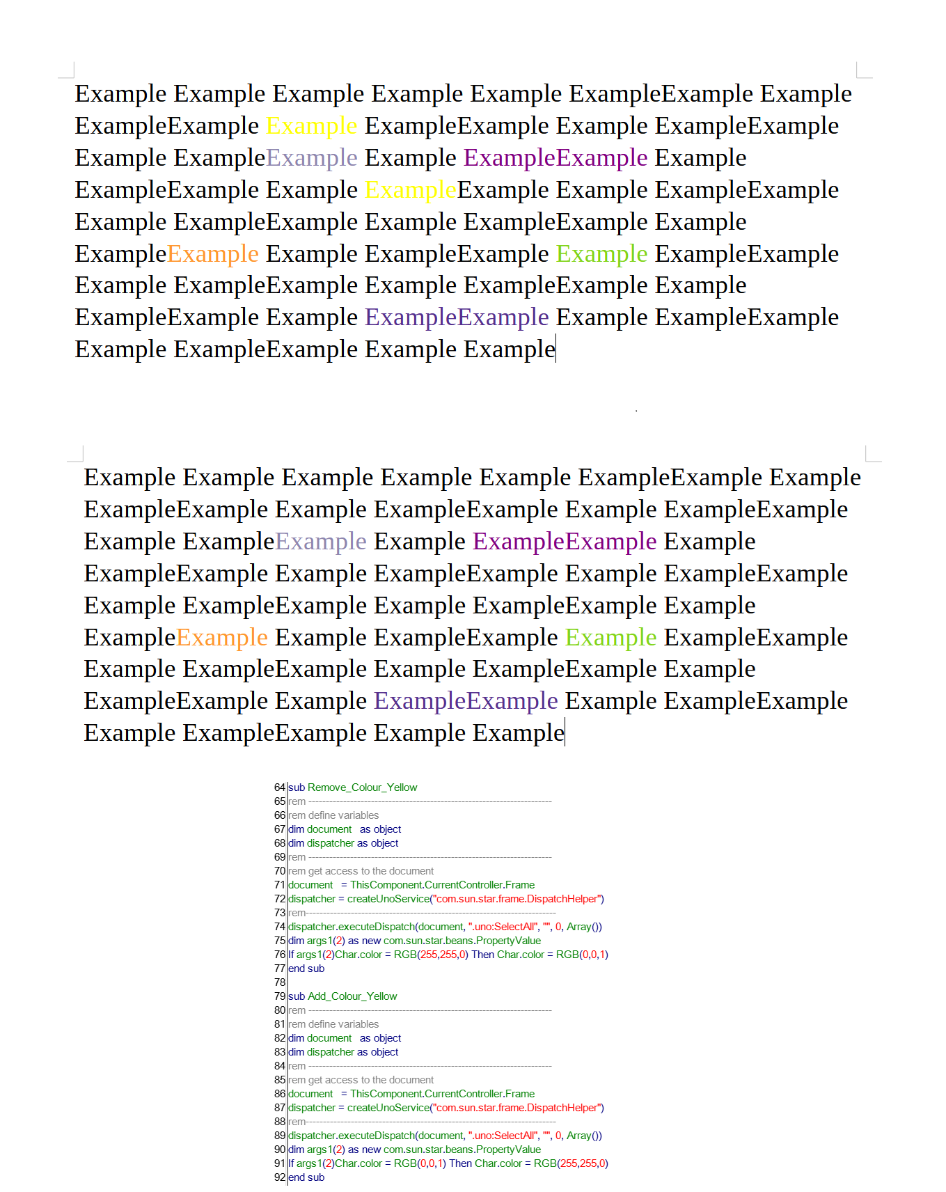

I’ve been struggling with this over the past week and I hope someone can help me out.
I would like to do the following using a macro: I want to seek out all the text with a specific text color and change the color of this text using a macro. In the example below for instance I would like to add a button that would only change the yellow text to black and then another button to go from black back to yellow. I have very little knowledge of coding so any help would be greatly appreciated. I have multiple versions of the same code and I have added the current code below, but none of them work.
Hello and welcome!

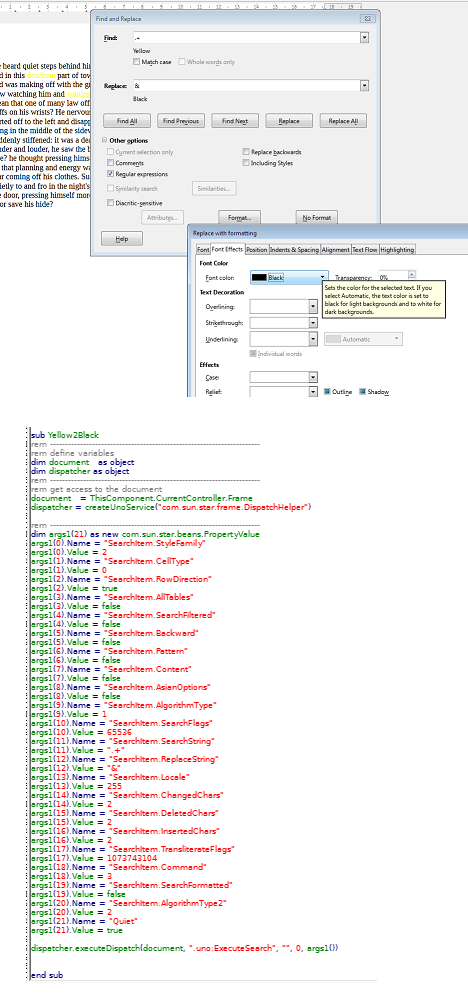

The first part of the task is solved very simply - you just need to use the Format button in the Search and Replace window twice to specify the format of the searched text and the format for the replacement text. The code for the resulting macro is shown below.
But the second part of your question will be much more difficult to implement. If you abandon the yellow font color, the text that was highlighted will merge with the rest of the black text. How are you going to remember which part of the text to color back to yellow?
Thank you very much for looking into this!
So this is what I’ve tried to do as well before by recording a macro. The macro you have works but then when you change the settings for the Search and Replace and you run the macro, it doesn’t work anymore for some reason.
How I tried to circumvent the problem of the text merging is by making the yellow text not entirely black. So I change it to RGB(0, 0, 1) for instance so that when I want to revert it, I can simply reference that one.
But the problem with the Search and Replace method is that once I have added both a macro for removing and for adding the text color, only one keeps working while the first now just does the same as the second is supposed to do. I think this might have to do with the possibility that the macro only executes the Find and Search command instead of actually filling in the previous parameters.

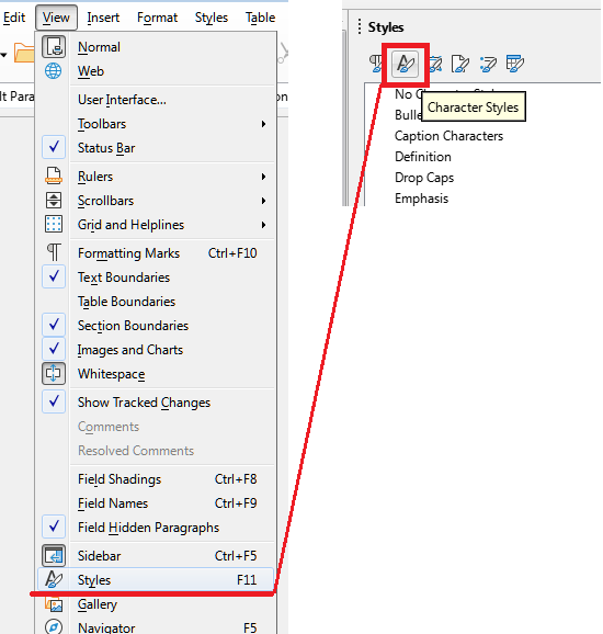

Have you heard of character styles? It’s here - Styles in Writer

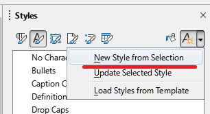

If you select a piece of text that is already colored yellow and use this tool
you can create your own character style and name it, for example, myYellow
