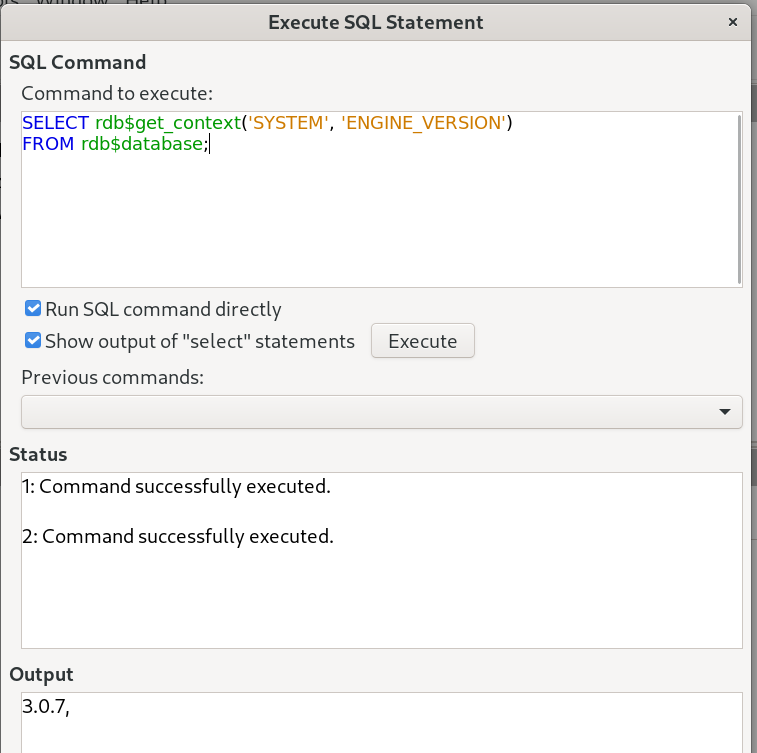

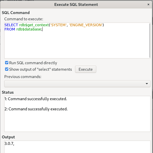

My environment: Windows 10 (2H22) / LO 7.1.1.2 / Embedded Firebird version? I don’t know how to find that!
