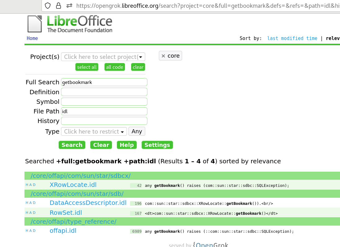

try opengrok getbookmark in idl
LibreOffice: RowSet Service Reference
LibreOffice: XRowLocate Interface Reference
@fpy OK, it’s a way to return to a specific row, but a row number is a way to return to a specific row. It can be a complex data structure, but in every case I’ve checked, it’s the row number.
BTW, your first link isn’t working.
Thanks for the response. The 2 working links hint at what’s going on with Bookmarks, so I’m not quite as clueless as I was before.
hum. pity. seems you have to restart from https://opengrok.libreoffice.org/
