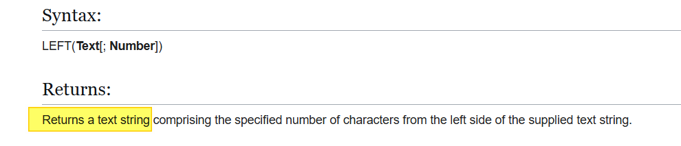

Consequently, you have to convert the text into a number and you do this with the value function.
e.g.: =VALUE(LEFT(B3,LEN(B3)-2))

THANK YOU. Lesson for me here is to dive into the documentation of each command I’m using if I get stuck like this in the future.
It would appear that simply formatting a cell containing a text string as a “number” does not actually make that text string a number. This is good learning for me!
