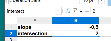

You do not need a label but a named expression: menu Sheet > Named Ranges and Expressions > Define
NamedExpression.ods (28.1 KB)
For a single cell you can mark the cell and then enter the name in the name field as well. And when a cell has a name assigned, you see its name in the name field, when the cell is active.
namedExpression

Thanks, Regina, for your suggestion!
I have tried that, but I had come across two problems:
  1. Suppose I want to use “slope” and “intersection” in a new formula in cell B5.
    I click on C3. enter “=” and then have to type “slope*A5+intersect” manually
It would be much more intuitive to enter “=” and then click on B2 and have “slope” inserted automatically. As described in the post above, which i composed while yours was posted, it would be nice if could use “right-click” or “shift-click” to to insert the “name” and the normal “left click” to insert the address.
  1. In your NamedExpressions.ods, the actual name of the cell “B2”, “intersect” and the text in cell A2, “intersection” differ!
I fell into the same trap in my “Workarounds.ods” at least twice! It would be nice if there was a function that I could enter in cells A1 and A2 that would retrieve the names from cells B1 and B2 and display it without the chance of introducing an error. Maybe that would be possible with a macro?
