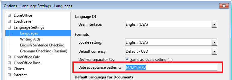

I didn’t express my idea well. You can change the date recognition template. For example: M/D/Y;M-D. You will know that to enter “January 2”, you need to enter 1-2, to enter “half a teaspoon” you can enter 1/2

Choose Tools - Options - Language Settings - Languages, set Date acceptance patterns
Try to do as it says in the help.

1/2 is a date (Feb-1 or Jan-2 of the current year) if the date acceptance pattern includes D/M or M/D .
