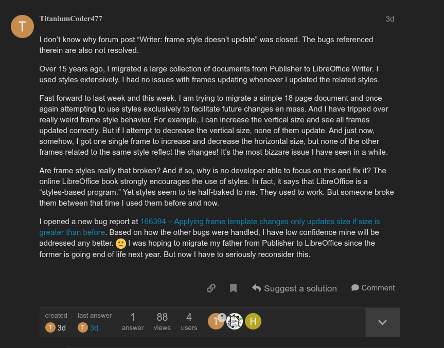

Frame style still not updating frames correctly
I don’t know why forum post “Writer: frame style doesn’t update” was closed. The bugs referenced therein are also not resolved.
Over 15 years ago, I migrated a large collection of documents from Publisher to LibreOffice Writer. I used styles extensively. I had no issues with frames updating whenever I updated the related styles.
Fast forward to last week and this week. I am trying to migrate a simple 18 page document and once again attempting to use styles exclusively to facilitate future changes en mass. And I have tripped over really weird frame style behavior. For example, I can increase the vertical size and see all frames updated correctly. But if I attempt to decrease the vertical size, none of them update. And just now, somehow, I got one single frame to increase and decrease the horizontal size, but none of the other frames related to the same style reflect the changes! It’s the most bizzare issue I have seen in a while.
Are frame styles really that broken? And if so, why is no developer able to focus on this and fix it? The online LibreOffice book strongly encourages the use of styles. In fact, it says that LibreOffice is a “styles-based program.” Yet styles seem to be half-baked to me. They used to work. But someone broke them between that time I used them before and now.
I opened a new bug report at 166394 – Applying frame template changes only updates size if size is greater than before. Based on how the other bugs were handled, I have low confidence mine will be addressed any better. :frowning: I was hoping to migrate my father from Publisher to LibreOffice since the former is going end of life next year. But now I have to seriously reconsider this.

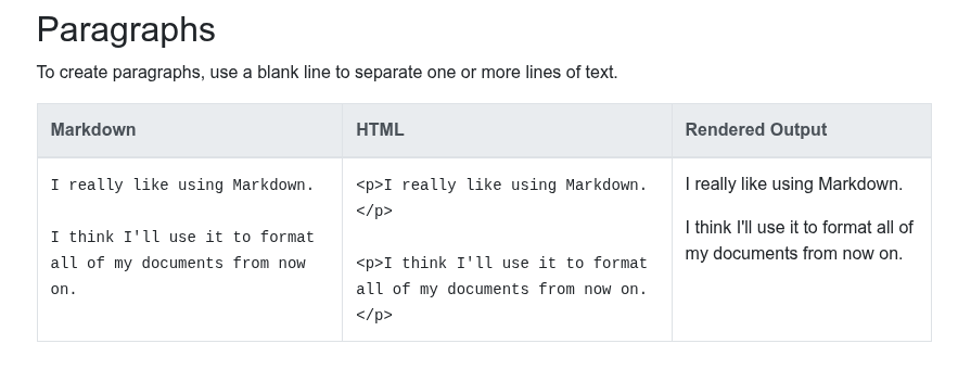

(And please tell me how to fix the formatting of these replies! It’s very frustrating to type this all up and watch it get smashed together as if in one big paragraph!)

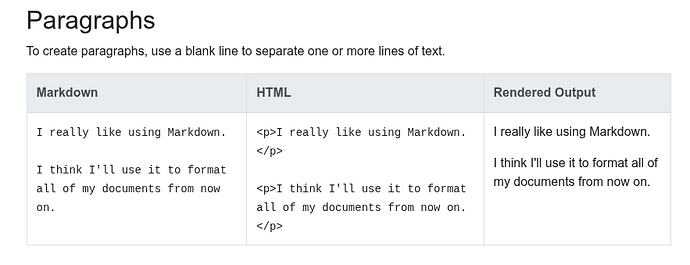

This site is formatted with Markdown syntax (see also here). This means that what you type is primarily interpreted according to HTML rules where whitespace is reduced to a single character (thus eliminating spacing between paragraphs). But basically, it is HTML.
Consequently, to space apart paragraphs, I start a new one with <br> which is not filtered out by the Discourse engine.
You can also add other HTML tags. Not all will be accepted by Discourse, but most of them are.

I should not have to add two lines of separation in order to achieve one in rendering. And even when I did try that, it did not work. The results were still mashed. I will go ahead and give HTML a try. Thank you again!
