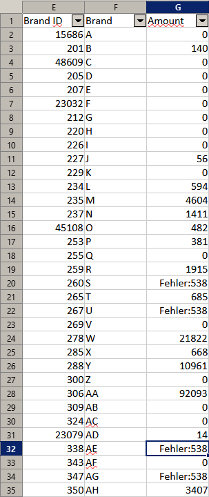

Let me visualise the issue at least with a screenshot. As you can see I do get results in most of the cells. The results are also correct. But the column G shows several errors in line 20, 22, 32, 34.
The formular is the same for the whole column, except the referrence to “E” always points to the cell in the same line.
=SUMPRODUCT(($Table1.$C$8:$AD$100007=E20)*$Table1.$B$8:$B$100007)
This is one part of the file. I have multiple areas like this with different set of IDs but the build is equal. I have the feeling that the error starts appearing when the formular is used more often in that file. Which would be wierd.

So more or less just a recalculation made the result disappear and the error appear. It cant be some formating issue.

While building the file for the upload I think, I found the reason for the error. While building it the program crashed several times.
It seems to be a performance issue. Not sure if it is the enviroment or the portable version of LibreOffice.
Anyway I opened the file on an other PC with the installed version and the file worked totally fine. No issues at all.
The errorcode was missleading.
