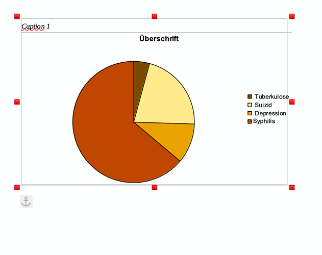

I am having problems with chart and captions in the writer.
  1. I generated a chart and modified it.
  2. I pressed “insert caption” and wrote something.
  3. When I close libreoffice and reopen it the caption is displaced and when I try to delete it, the whole chart gets deleted?
Please help, my assignment is due on Monday. Thanks in advance!

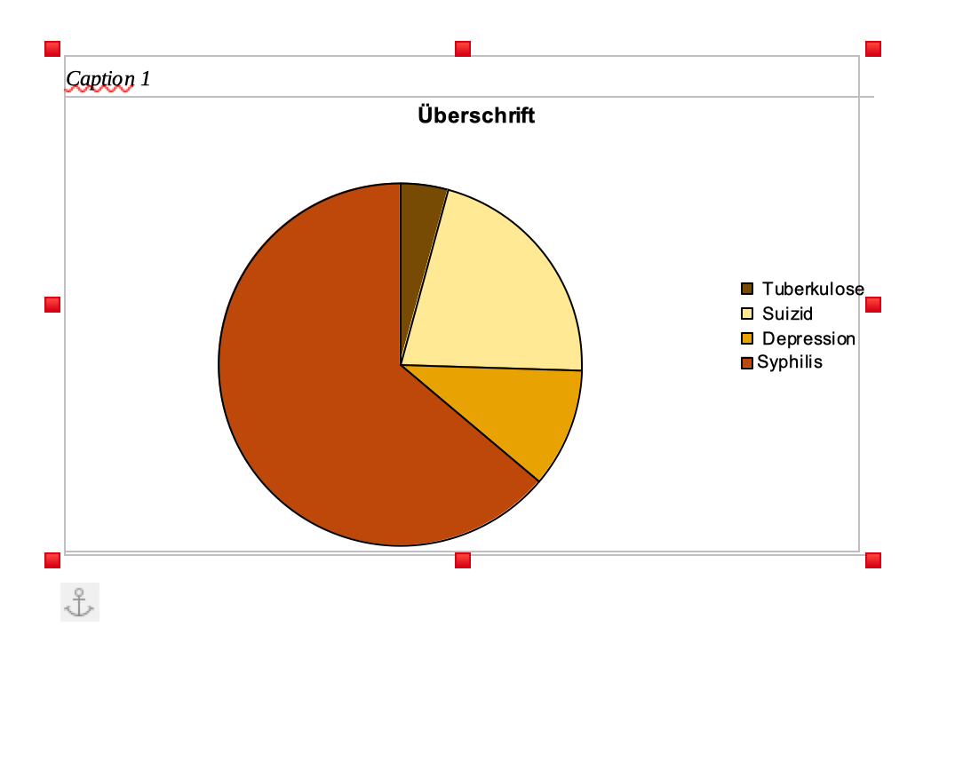

Reopening:
Clarification: Before closing the Caption is at the bottom. Also after reopening I can not copy the chart anymore, It just pastes the chart, that was preselected before.
