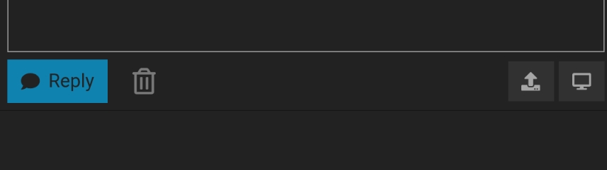

Open a comment first
On mobiles I see the symbol now in the lower right corner of the edit-window.

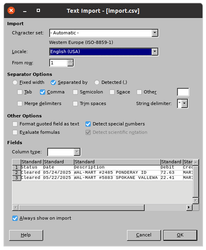

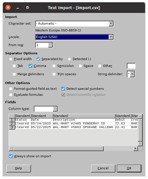

In order to import correct data from this flavour of csv into Calc, you would have to fill out the import dialog like this:
