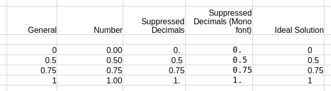

This image shows what I’ve tried and I go into a bit more detail below that. Please note that the ‘Ideal Solution’ column has been graphically edited from the output shown in the ‘Number’ column.
LibreOffice Calc Numeric Formatting
I looked in the Help and found the section on number formats (file:///usr/share/libreoffice/help/en-GB/text/shared/01/05020301.html).
I applied the format 0.?? as the documentation states:
The ? works as the # but adds a space character to keep decimal alignment if there is a hidden non-significant zero.
As you can see from the image, the decimal alignment only works if you’re using a monospace font. This may be a bug, but I don’t know the software well enough to decide. I tried to fix this by using the underscore character to specify space width, but found that it was for inserting an actual space rather than specifying the width of all spaces in the format.
At this point, I’m assuming that what I want to achieve is not possible, and I’m using the monospace font approach.

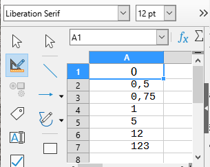

imagen
EDIT 2:
If do you paste a tab character at the left, you get
imagen
but I couldn’t find a way to align them in another position.

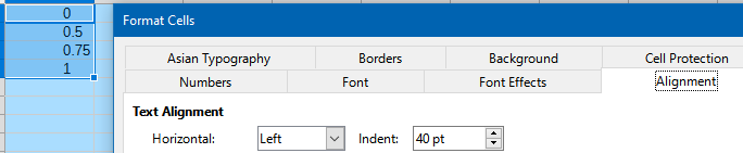

Just select the Standard number format (as @karolus stated), and change the Alignment and Indent as shown in my first comment.
imagen
I didn’t see the image the first time I saw your reply, but the image solved it for me. Many thanks.

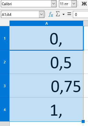

Number format: # ##0,??
Снимок экрана 2025-06-24 160429
As @SlowLearner1 explained, and shown in the comparison screenshot, the picture that you show differs from the ideal case, when there is no decimals. The ideal solution will not include decimal separator.
However, the “adjust to decimal separator” seems to imply the decimal separator :slight_smile:
:slight_smile:
