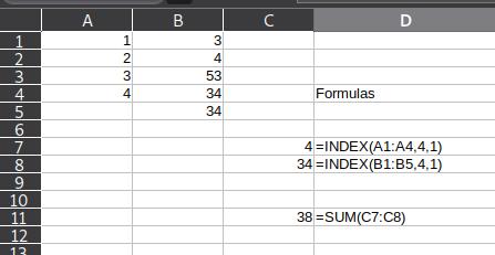

I just created a very small example which sum over values of index and the result looks ok for me.
image description
Or maybe i misunderstood your problem.
