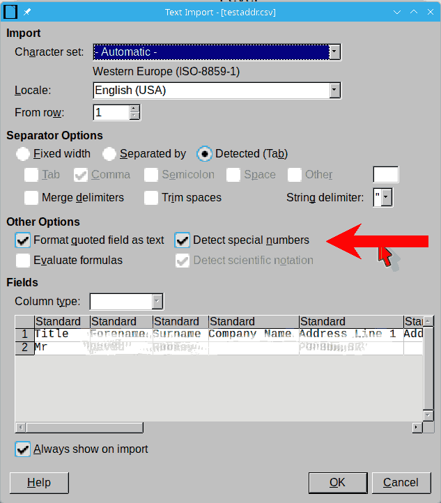

You may find life less frustrating if you ensure that Detect special numbers is checked when importing CSV files.
I retried, and it did help! The preview in the Text Import dialog looks the same (left aligned), but the spreadsheet treats them as numbers and formats the column as currency :+1: .
Another wrinkle is this particular CSV had numbers in quotes like `"$100.00", probably so amounts like “$1,200” are not treated as two items separated by a comma. So I had to disable “Format quoted field as text” as well as enable “Detect special numbers”. Fortunately the CSV only had a few large amounts with comma digit separators.

When importing text from clipboard or from tabular text files (e.g. csv), always check “Detect special numbers” and make sure that the chosen locale matches the locale of the data to be imported. Choose an English locale when importing decimal numbers with points as decimal separator. Choose “English (USA)” when a date string like “01/02/2026” refers to the second of January. Choose “English (UK)” when the same date string “01/02/2026” refers to the first of February.
