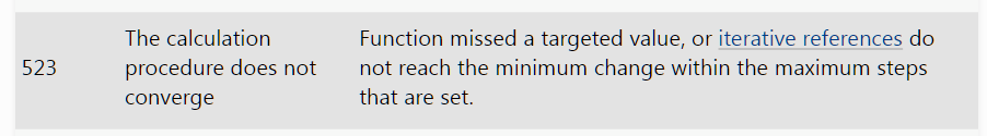

Yes, thatâs exactly how spreadsheets work - something is entered into cells designated for input data and as a result of a chain of calculations (sometimes quite long) the result is displayed in OTHER CELLS designated for output. In very rare and simple cases - as in the example from the help - iterations can cope with the task of cyclic calculation. In other cases - that is, in the vast majority of cases - you will get error 523
