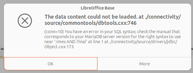

JDBC here…
No matter I try be it in ISO format or American (my LO’s locale is set to US), query fails.
Please take notice that it is in parsed mode (of course!).

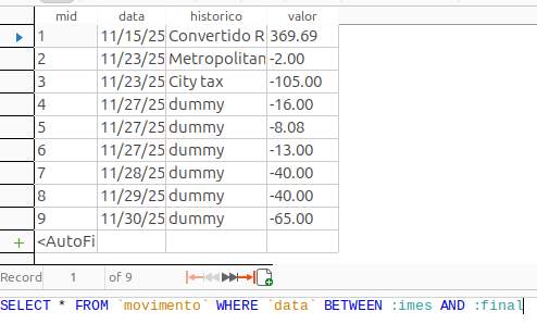

movimento_parameters
parameter_query_fails
Rem: the data in grid is from previous hard coded query.
Hard coded it runs :ok:
movimento_hard_coded

Also connection with JDBC will support parameters. Here I detected parameters should have length with more than 2 characters. Connection runs here with maraiadb-java-client-3.5.6.jar.
Might be you could choose something for named parameters in Edit → Database → Advanced Settings. This depends on the driver you use. (Bug 50747)

ReplaceNamedParameters
QueryRunsOK
Why is this on by default? Why/when should it be on anyway? And why is this option unavailable with the SDBC driver?
No, to me it was not. I checked it and then… parameter query worked!
I misunderstood the option. when checked, it accepts the :name and then sends ? to the engine, right?
When checked it accepts the parameters :+1:
What it sends I don’t know. But query runs :grimacing:
