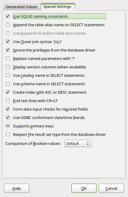

No, to me it was not. I checked it and then… parameter query worked!
I misunderstood the option. when checked, it accepts the :name and then sends ? to the engine, right?
When checked it accepts the parameters :+1:
What it sends I don’t know. But query runs :grimacing:

Only this options will be available in LO with direct driver and connection to MariaDB through JDBC with mariadb-java-client-3.5.6.jar
This will be the default when connecting to MariaDB through JDBC directly, not by wizard “MySQL/MariaDB”.
grafik
This is the bare minimum, I expect from any type of database connection. It works with dBase, HSQL, H2. The same form does even work with spreadsheet data if you store the criteria on sheet. Firebird can do the same, if you know some tricks. I found at least one complex subform query where Firebird fails.
MariaDB can do the trick with JDBC, ODBC but not with SDBC.

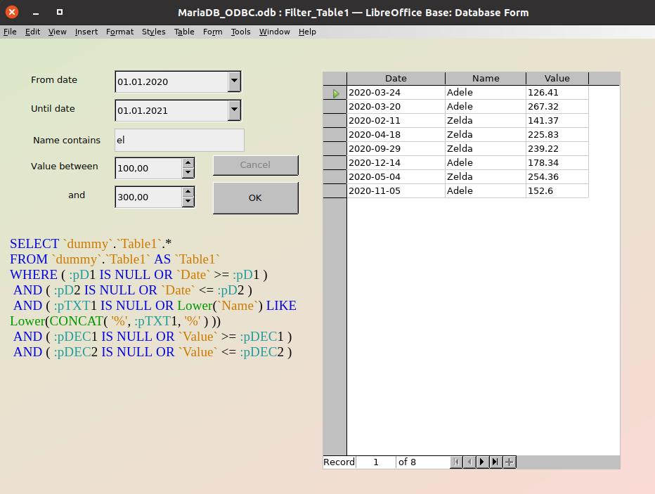

SDBC with same database, same query and form:
The data content could not be loaded.
You have an error in your SQL syntax; check the manual that corresponds to your MariaDB server version for the right syntax to use near ‘:pD1 IS NULL OR Date >= :pD1 ) AND ( :pD2 IS NULL OR Date <= :pD2 ) AND (…’ at line 1
With the most simple setup (Parent Field=Slave Field) I get the same error:
You have an error in your SQL syntax; check the manual that corresponds to your MariaDB server version for the right syntax to use near ‘:link_from_TXT1 )’ at line 1

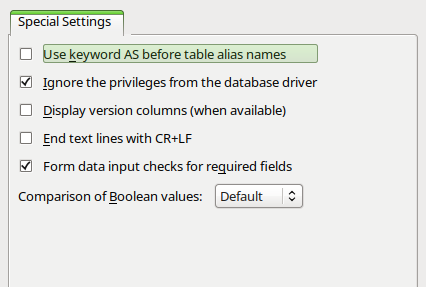

The obscure option "Replace parameters with ?" does not exist with this type of connection.
Built-in MySQL driver (SDBC)

The option "Replace parameters with ?" is very old. It had been an option for every PostgreSQL-connection and every MySQL-connection when I created first Base Handbuch for LO 3.5 13 years ago. And it is the reason many people couldn’t get forms working with subforms. This option is also set in internal HSQLDB: db:parameter-name-substitution="false" (see content.xml) but would be ignored by HSQLDB. It is also a problem when migrating from HSQLDB to Firebird: Firebird reads this value “false” and subforms or parameterized queries won’t work with an automatic migrated database…
Even a trivial master-slave relation between two columns without any parameter fails. And as already said, the same query with the same form works with Maria over JDBC and ODBC and with any other type of database (backtick quotes replaced).

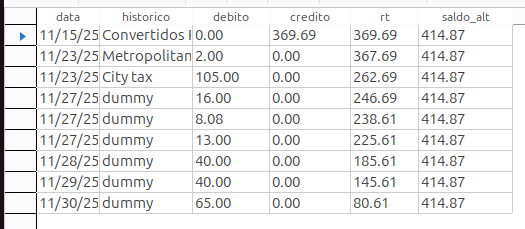

Another very strange thing – this is the query source for my simulacrum of a monthly bank statement.
November
  • imes = 2025-11-01
  • fmes = 2025-11-30
If I enter the parameters ISO format query runs :ok: (of course).
If I enter in American format as per my locale here, query from “movimento” view runs, but subquery (that returns previous end of month balance to be added to running total in the report) does not run!
No need for the SUM() of course.
ISO
AmericanDate
