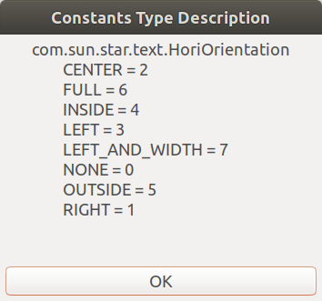

That is a constant, not a structure that you need to create an instance of like in your original question. For constants you can do this.
HoriOrientation = com.sun.star.text.HoriOrientation
oLine = HoriOrientation.FULL
Снимок экрана от 2021-09-02 20-31-05
