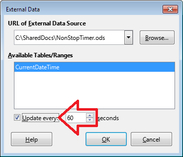

Create a new spreadsheet. It will be a very small spreadsheet in which you write one =NOW() formula. Give this cell a name such as CurrentDateTime. Save this table in a convenient location.
Now add a helper sheet to your main spreadsheet and fill in two cells. In the first of them, for example, in B1, insert a link to the cell CurrentDateTime (сhoose Sheet - Link to External Data)
getNOWfromExternalSpreadsheet
In the adjacent cell, write down a formula that, when the desired condition is met, will run your macro, something similar to =IF(INT(B1)=INT(DoSomething.$B$1);"Wait...";MY_MACRO())
Of course, MY_MACRO() should be a function that will perform all the planned actions, return some value to display in the cell (for example, the text “worked!”) And - IMPORTANT! - will change the value in the cell DoSomething.$B$1. Since this cell is on a neighboring sheet, the function will be able to change it - usually such actions are not recommended, but since you know exactly what you are going to do, you have every right to do so.

There is another solution: create a link to an external file, and then delete it. The link will stop working and generate an error. However, the link update will be called regularly. This will lead to the correct recalculation of the function =NOW() in the current spreadsheet, and the result of this function is used as a timer. This eliminates the need for a second file. I don’t really like this decision - to feed Calc with a deliberate mistake? No, do not like it…
You can resist everything except temptation?
Of course! Like any programmer, I’m lazy. Laziness is a great engine of progress: it helps to resist everything … and even some not very strong temptations :slight_smile: :laughing:
To comfort you concerning your remorses:
Links of the used kind are presented as Links to External Files by the UI. They simply are Links to Named Ranges, and such a link works the same way -including the automatic update- if the range is internal, even if its output goes to the same sheet.
Going this way you feed two birds with one breadcrumb: You have your timer, and you feel comfortable having avoided the fake link. I just tested it, and would like to have you also testing it with the attached file. The update interval is set to 10 s. It should work in every location.
