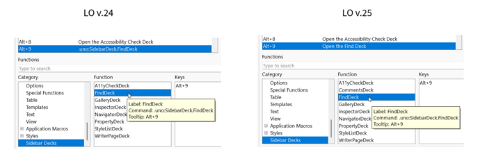

ctrl-f sends the cursor to the find bar on the bottom. The find window on the sidebar seems much better, but when I go into customize menu to change the hotkey to that, the only commands I see are ‘find’, ‘find and replace’, and ‘find record’.
Where is the command that opens the find sidebar so I can hotkey that to ctrl-f instead?

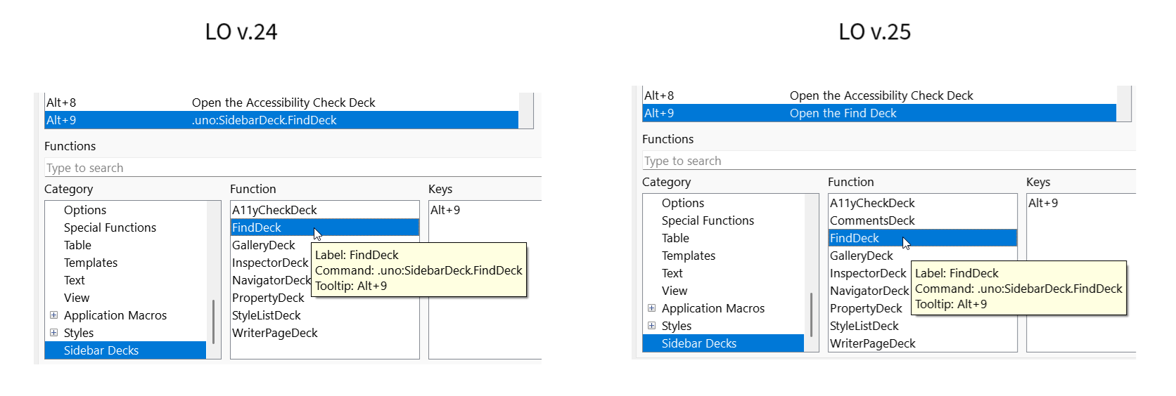

Solution: The command is called just “find deck” and it’s not under “all commands”; it’s in the “sidebar decks” category.
