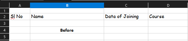

Screen Shot of Before_Macro

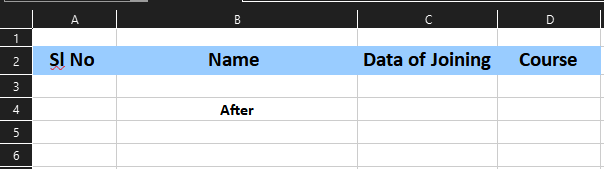

Screen Shot of After_Macro

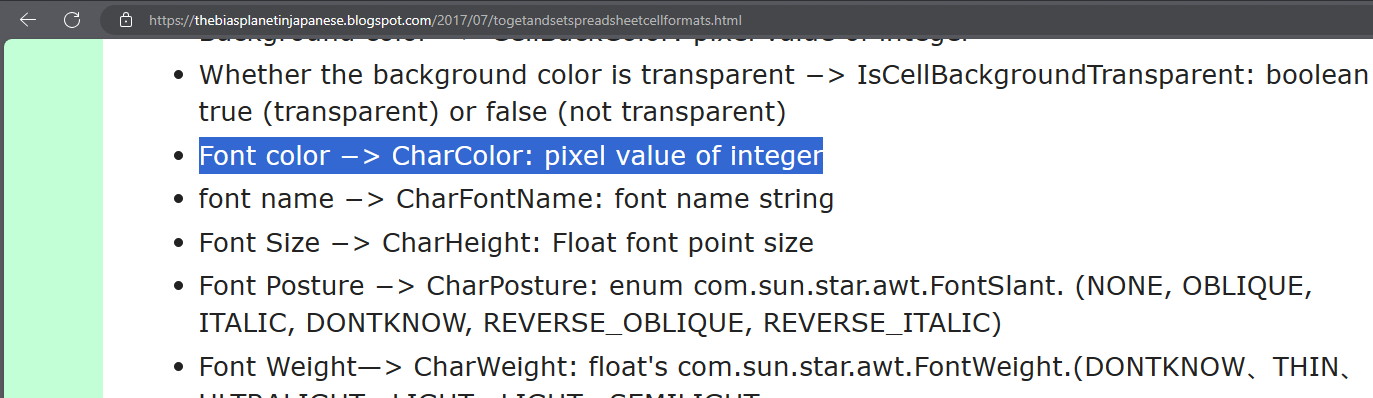

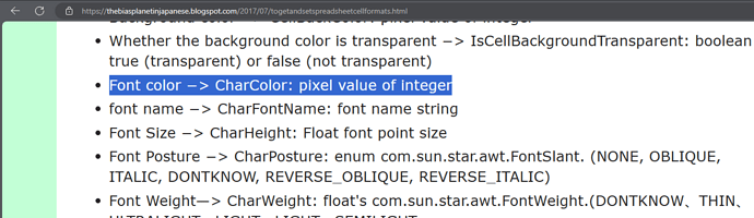

Hi @vib, thanks … Even me also got it From Japanese Website Just Translate From your browser.
Website

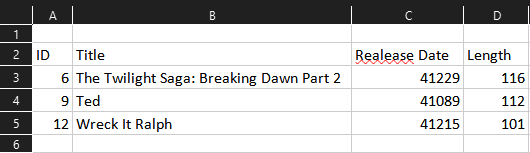

Screen Shot of Before Running Macro

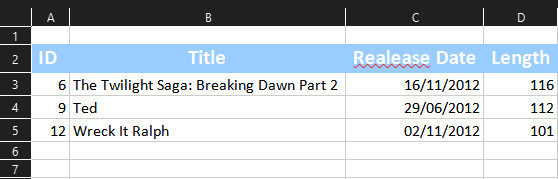

Screen Shot of After Running Macro
