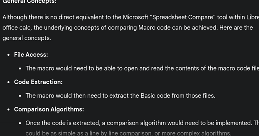

short answer: not easily.
AI will bore you as to why … :wink:
