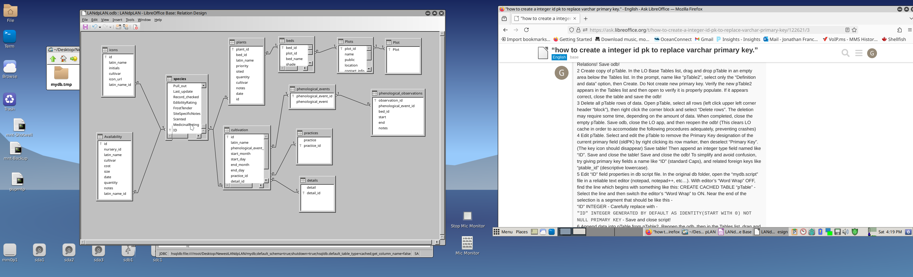

"how to create a integer id pk to replace varchar primary key."
Have a database with a varchar primary key. skyandrews said that it will load faster if I create an integer primary key instead. There are several tables relating to the varchar primary key. How can I edit all of the tables to make the database run faster?

I tried:
UPDATE "plants” SET “id” = SELECT “ID” FROM “species” WHERE “plants”.“latin_name” = “species”.“Latin_name”
I got:
1: unknown token: at ./connectivity/source/drivers/jdbc/Object.cxx:173
it’s a problem with the quotes. This worked:
UPDATE "plants" SET "id" = SELECT "ID" FROM "species" WHERE "plants"."latin_name" = "species"."Latin_name"
UPDATE "cTable" SET "ptable_id" = SELECT "ID" FROM "pTable" WHERE "cTable"."oldFK" = "pTable"."oldPK"
Yes. I apologize for using smart quotes for the instructions. When copying from smart quotes into sql, all typographic quote marks must be edited. Also a child table’s foreign key should be named like “species_id”, not just “id”. A foreign key should be somewhat descriptive about which table holds the related “ID” primary key… hence “species_id” or “speciesID”.

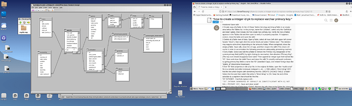

  • Here is an embedded version of the tables showing the new Integer primary and foreign keys, created in the split version using the 10 step suggestion.

I did it! THANKS FOR YOU HELP. I still have to rename the column on the species table: id and rename it to “species_id”. Any tips to do that?
<hsql_install_dir>/hsqldb/doc/guide/databaseobjects-chapt.html#dbc_renaming
