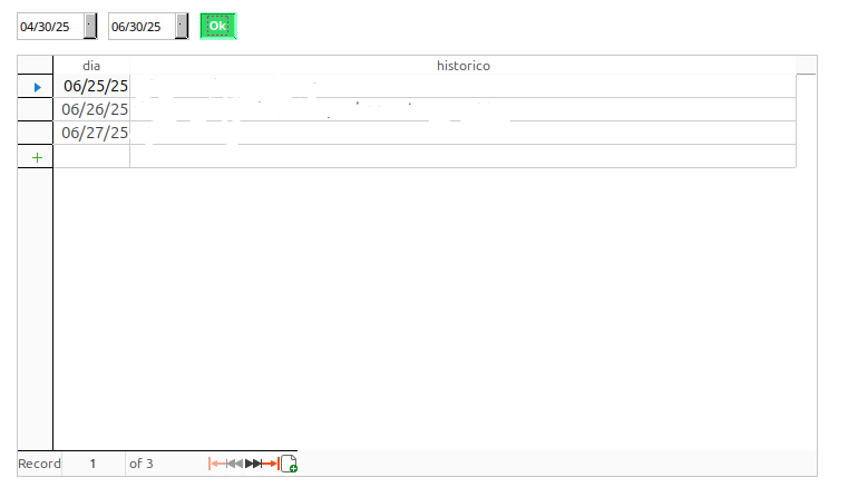

Table View filtered from 30 April to 30 June.
Same structure of yours: | date | description |

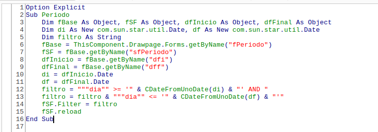

So pursuing this no Filter Table way we need to write the filter for the subform.
Tools > Macros > Organize Macros > Basic
select your .odb in the list at left > New > Module (will name “Module1” as default).
Write in it - of course the names you assign at your choice:
Option Explicit
Sub FiltroPeriodos
'declare variables for Main (oFM), SubForm (oSF) and date controls start and end period;
	Dim oFM As Object, oSF As Object, oDFS As Object, oDFE As Object
'declare variables for the date fields contents (the dates inserted there):
	Dim ds As New com.sun.star.util.Date, de As New com.sun.star.util.Date
'declare variable for the string of the filter:
Dim filtro As String
'get a reference to the main form:
	oFM = ThisComponent.Drawpage.Forms.getByName("frm_Program History")
	MsgBox "teste!"
End Sub
Save and execute the code (Macro) FROM THE FORM.
At this point it’s only to check for errors. It will only show up the message “teste!”
If there are no errors assign it to the button:
button Properties > Events tab > “on approve” (first option = Access OnClick) > Macro > this macro > Ok.
And check if the macro runs from the button of course.
