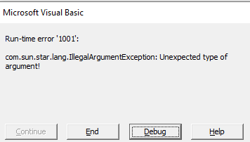

The following VBA macro fails with an error:
Sub TestCreateSequenceInputStreamFromByteArray()
  Dim aData(20) As Byte, v
  Dim oSM As Object, oSIS As Object
  Set oSM = CreateObject("com.sun.star.ServiceManager")
  Set oSIS = oSM.createInstanceWithArguments("com.sun.star.io.SequenceInputStream", Array(aData))
  Set oSM = Nothing
End Sub
Screen 2025-08-03 172145
@sokol92 maybe you get not an array of anys from Array(aData)?
I did it in analogy with this topic.
Microsoft Visual Basic? I have no idea how the bridge will work from there. I very much suspect that no, that doesn’t coerce to array(any).
This is an optical illusion - a message from VBA. :slight_smile:
Some time ago the guys from MS forgot to fix it.
