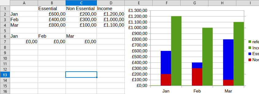

In the sample file, I see them one behind the other.

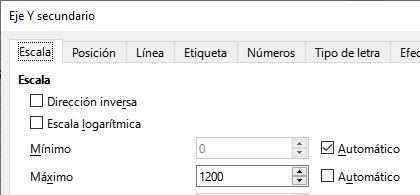

For what do you do that? You need the same scale for outgoing and income.
Oh, I just understood when deleted the secondary Y axis. You must set the Maximum of the secondary Y axis to the same value of the primary Y axis:
imagen
And be sure that the minimum remains at 0.

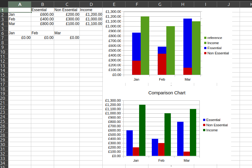

column chart experimental acurate LeroyG.ods (22.7 KB)
I’m don’t know if you fiddled with the Essential values so the comparison between outgoings and income is real: i.e., in January it appears that the outgoings are half the income (which is not real if Essential sums £600,00), because there are only £400,00 visible of Essential over the Non Essential.

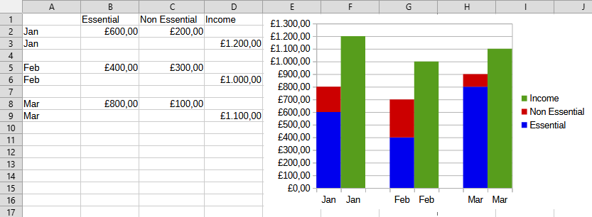

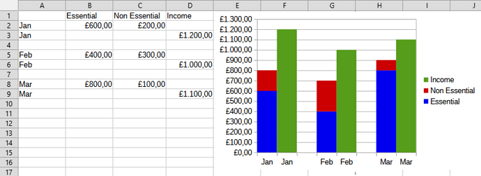

EDIT:
Sample done with stacked bars:
column chart experimental acurate LeroyG_2.ods (17.4 KB)
Thanks for the reply and for the sample spreadsheet attachment. I apologize for missing the scale option, I now understand what I did wrong there.
As for the values, I now realise the difference between Excel and Libre Office. In the sample xls file that I attached, this method actually stacks the totals together to reach the correct values. In the odf file, both values are taken from the base of the chart and not combined into one stack.
