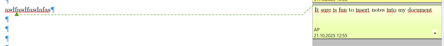

Here is a slightly modified example from A. Pitonyak’s book AndrewMacro.odt .
Sub AddNoteAtCursor2()
  Dim oDoc as Object, oViewCursor as Object, oTextField as Object
  oDoc = ThisComponent
  oViewCursor = oDoc.CurrentController.ViewCursor
  oTextField = oDoc.createInstance("com.sun.star.text.TextField.Annotation")
  With oTextField
    .Author = "AP"
    .Content = "It sure is fun to insert notes into my document"
    'Lets lie and say that this was added ten days ago!
    .DateTimeValue = CDateToUnoDateTime(Now() - 10)
  End With
  oDoc.Text.insertTextContent(oViewCursor, oTextField, False)
End Sub
Thanks, but does that really create the annotation over the whole cursor range for you? For me it only creates comment at the start of the cursor range, which is the same what the accepted reply would do without the .End in range.Text.createTextCursorByRange(range.End).

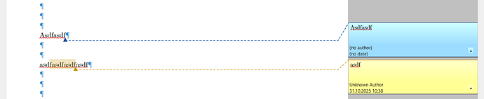

Sorry, I didn’t understand the question at first.
I couldn’t get it to work without the “.uno:” commands.
The “archaic” methods seem to work.
To check, select a text range and call the TestInsertAnnotation macro.

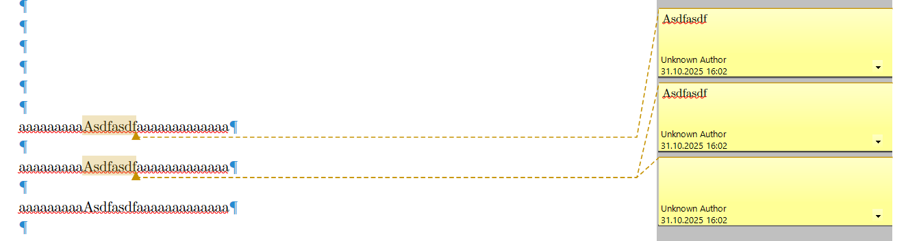

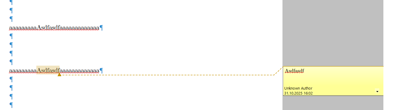

While that does work as you say when I try to use it as you suggest, if I try to use it in the context of the original question, it works maybe 3 out of 5 times.
Sub CreateComments(searchText as String, commentText as String)
	search = oDoc.createSearchDescriptor()
	search.searchString = searchText
	ranges = oDoc.findAll(search)
	For i = 0 To ranges.Count - 1
		InsertAnnotation(oDoc, ranges.getByIndex(i), commentText)
	Next
End Sub
In order for us to compare the results, please upload the file and indicate which macro should be run.
Right, sorry. The macro is TestCreateComments.
lo_test_2.odt (13.9 KB)
A common mistake in such cases.
You’re changing the document’s contents inside a loop.
So
For i = ranges.Count - 1 To 0 Step -1
Thanks. Five comments after clarifying the macro code.
Ah, I see, that didn’t occur to me. In my defense, that’s how the macro in the accepted answer did it, and I just copied it, because I’m not really familiar with how it all works. Thank you so much for your help!
