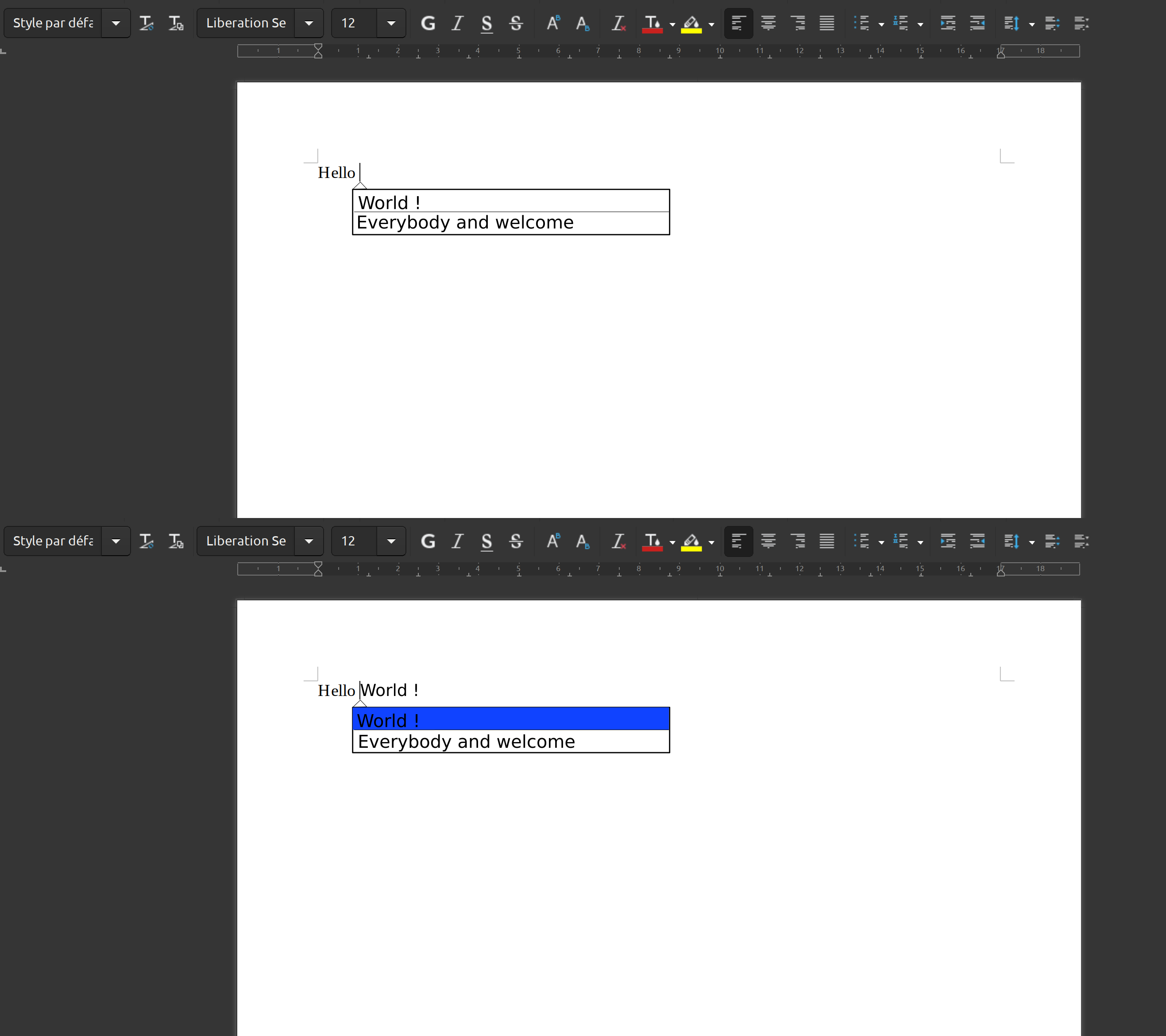

I would like to make an extension on LibreOffice on python. I need to display some sentences at the bottom of the text slider. Like the image (I make it):
I also would like to coloured the box of a sentence.

That design says “listbox” to me. Would Python - Tkinter Listbox be any help? I suppose that you have a list of typical first words for the quotes entries, that you then search a list with all possible lines for matching items, and then you add those items to the listbox.

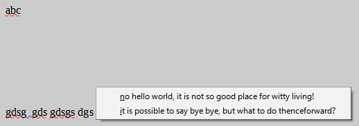

I know one easy popup window in Basic, but I don’t know how to recalculate the position X,Y from ViewCursor to the PopupWindow coordinates.
Sub showPopup
	dim oDoc as object, oWindow as object, oVCur as object
	dim aRect as new com.sun.star.awt.Rectangle, oPopup as object, n&, c&
	oDoc=ThisComponent
	oWindow=oDoc.CurrentController.Frame.ComponentWindow
	oVCur=oDoc.CurrentController.ViewCursor 'view cursor
	aRect=CreateUnoStruct("com.sun.star.awt.Rectangle")
	aRect.X=100 'oVCur.Position.X -> i don't know how to recalculate the coordinates from the ViewCursor
	aRect.Y=100 'oVCur.Position.Y
	oPopup=CreateUnoService("stardiv.vcl.PopupMenu") 'or com.sun.star.awt.PopupMenu
	c=1
	oPopup.insertItem(c, "no hello world, it is not so good place for witty living!", 0, c)
	oPopup.setCommand(c, "item" & c)
	c=2
	oPopup.insertItem(c, "it is possible to say bye bye, but what to do thenceforward?", 0, c)
	n=oPopup.execute(oWindow, aRect, com.sun.star.awt.PopupMenuDirection.EXECUTE_DEFAULT)
	if n>0 then
		msgbox oPopup.getCommand(n)
	end if
End Sub
Andrew Pitonyak’s macro document section 7.17. Where is the Display Cursor? gives a routine called PrintCursorLocation that determines cursor coordinates. I added the following line at the end of the routine:
Call showPopup(dXCursor * 100, dYCursor * 100)
This calls the routine posted by @KamilLanda after making the following changes:
Sub showPopup(x, y)
	aRect.X = x
	aRect.Y = y
The result is a popup window shown by the viewcursor. Here is how it looks on my machine.
