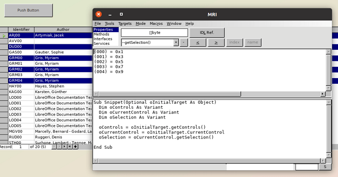

A table control with a push button (“Take focus on click”=False") calling this code:
Sub mri_FormController(ev)
srv = createUnoService("mytools.Mri")
srv.inspect( getFormController(ev.Source))
End Sub
getFormController is a handy function to get the form controller from any form or form control.
The MRI window shows the 1-based selection indices in hex notation for the current control’s selection.
You find getFormController and related code in https://ask.libreoffice.org/uploads/short-url/1yAlwoKjpgsuYkMrf25xCiFGReG.odt

Thank for your code. It works fine for me to the getSelection() line. But how to get data with XResultSet and XRow from oSelection ?
Store the position numbers in an array. Walk through the position numbers. The FormController’s FormOperations allow this. My sample code includes a routine Sub MoveToRecord_5(ev). For each record, read data from the form itself. A form is also a record set supporing methods like getString, getInt, getDate etc.
