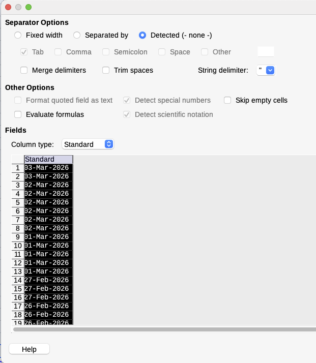

I managed to get it to work with a combination of @anon73440385 and @jackdaddee’s work…
(LibreOffice 25.8.2.2 on MacOS)
  1. Select the problematic dates.
  2. Click Data > Text to Columns
  3. Click the column header, which will probably say Standard
  4. This will turn the cell backgrounds black as shown in the screenshot.
  5. Change the column type dropdown to Date (DMY) or one of the other date formats
  6. Press OK
Even though you are converting 1 column to 1 column, the “Text to Columns” tool still does the job… hopefully…
If you convert D/M/Y dates this way while having a M/D/Y locale you get a mixture of wrong dates and text.
Instead of fixing wrong data, you better close the file and start again with the correct import options (correct locale and “detect special numbers”).
