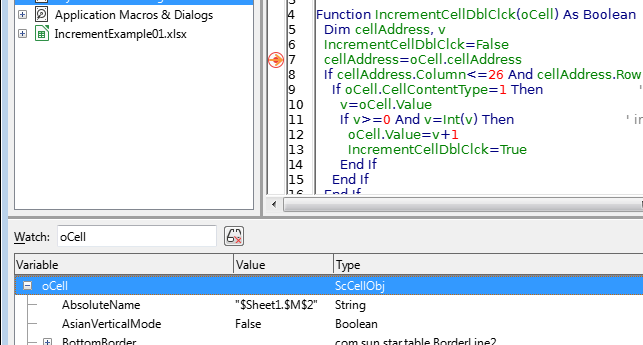

Thanks for the clarification - now I was able to reproduce the error. Indeed, a double click, for example, on cell M2 passes a ScCellObj type parameter to the function (as expected).

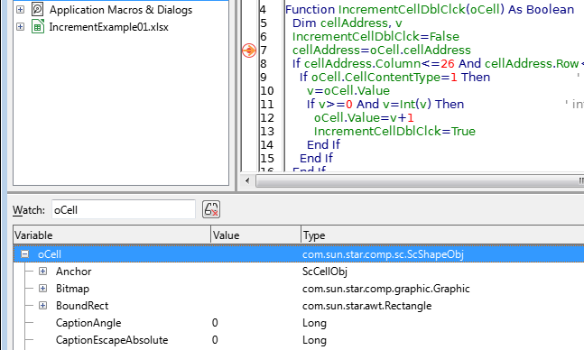

And clicking on a cell in the K or L column passes the Shape object as a parameter - and this is not correct.
Suddenly. Obviously wrong. I see an error, but I can not understand the reason yet.
Could you - temporarily, for the sake of experiment - re-save your book in the ODS format and check if the error remains when using the native file format?
Update Itâs hard to believe, but the comments to the cells in the previous column are to blame for the macro not working properly. Yes, comment pop-ups are not visible now, but they are there. And, apparently, double-clicking on a cell does not pass the cell to the function, but an invisible comment box.
