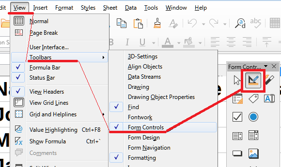

Put the example sheet into edit mode
Select a group of buttons, copy and paste anywhere on your sheet. Disable edit mode.

I hope that this video tutorial will help you make the necessary settings.
Yes, grand job! Thank you!! All working now. I understand how it all hangs together much better now - good exercise.
