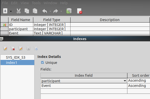

For your question I end up with three tables.One for Participants; one for Events; one for Attendance.
Attendance is linked to the Participants and within the Attendance record is a list box based upon the Events table.
In order to avoid duplicate Participants at an Event, the Participant ID combined with the Event was declared as Unique in the Attendance table:
Screenshot at 2022-07-17 15-38-17
A sample is attached with the tables, a single form and one query showing a list of entries:

Wow, thanks for the incredibly explicit help! Concerning table links, isn’t Attendance.Event supposed to be linked with T_events.ID?
@fred1917
Relations rejects it, possibly due to the unique setting of Participant ID combined with the Event.
May try to look at further later on.
It was my fault in overlooking the data type in Attendance table. Needed to be set to Integer. Changed this & link now OK:
Revised → FormSubForm.odb (13.6 KB)
