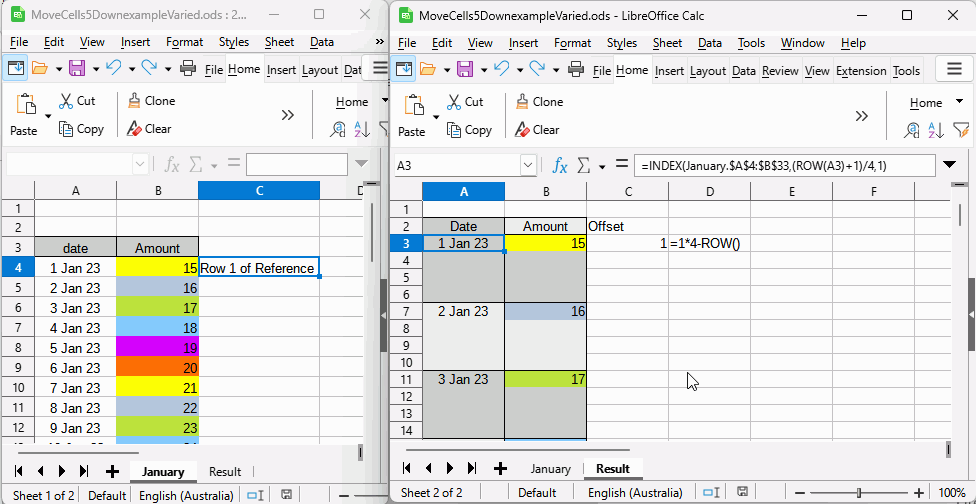

So with those changes we get =INDEX(January.$A$4:$B$33,(ROW(A3)+1)/4,1) and we use the same formula but change the final 1 for the column index to 2 for the Amount column
In image below I have calculated the offset of 1 using formula shown next to cell
Note if Cell A4 of January contains the Heading and the data doesn’t start until cell A5 (second row of the reference range) then you will need to calculate 2 x 4 before subtracting the row number of the first result cell from that calculation and making the total the offset.
